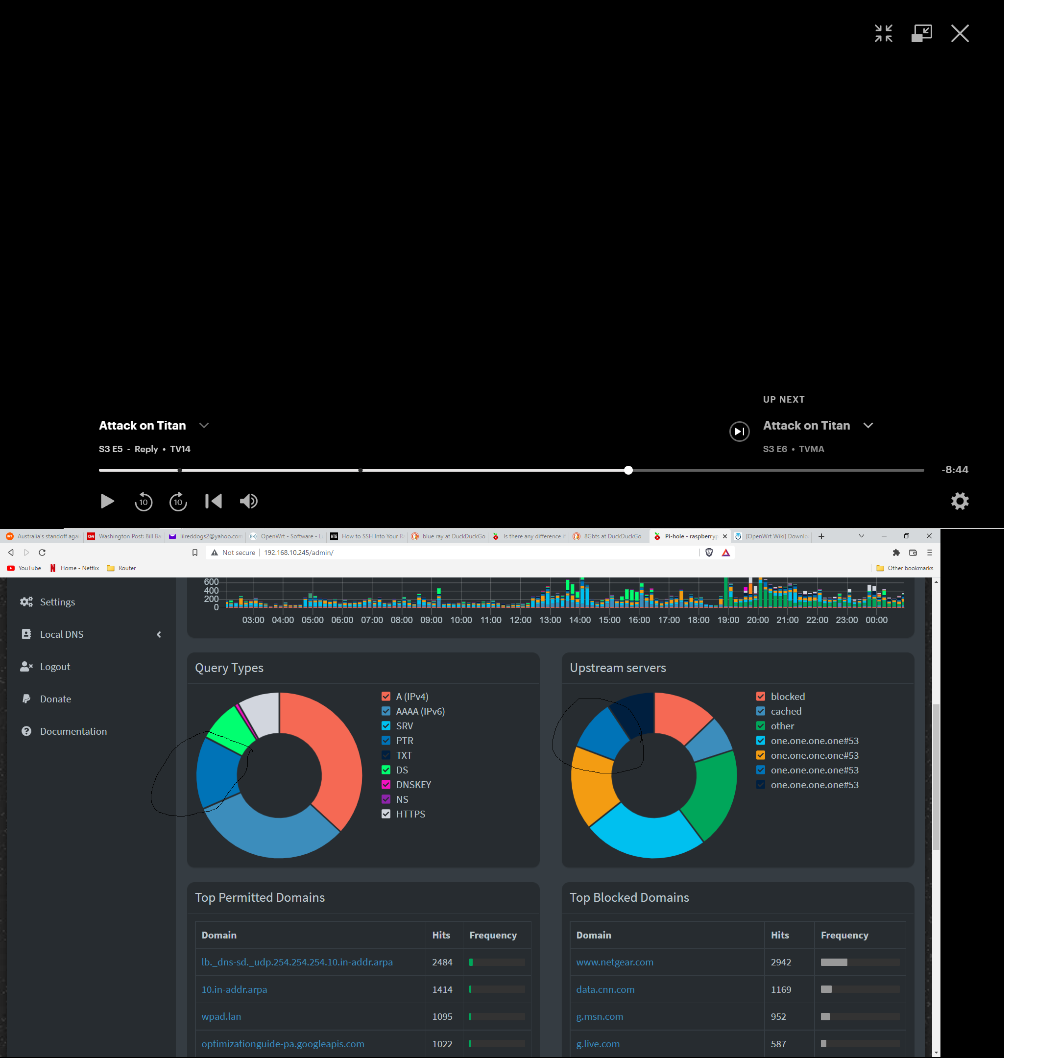

It is weird:
I do have IPv6 enabled on the router, but I still do not get ads.
I do see a lot of IPv6 inquiries, on both the Pi-hole and traffic on the router, but still no ads. ~26-30% blockage in the Pi-hole.
I get some ads on Safari, a TON on YouTube, if I use the app but primarily I use Brave.
Anyway: everything works on my end. I was just trying to see why they do not on theirs and they seem to have time sync issues I do not.
