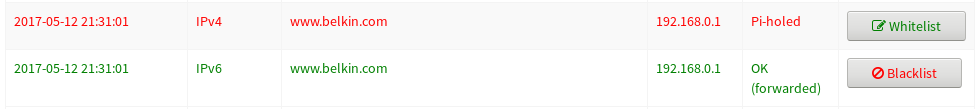

I have a Linksys WRT3200 router. This router is "calling home" very often. I blocked that domain.
The IPv4 gets blocked and the IPv6 not. I can't add the IPv6 one to the blacklist.
Any idea?

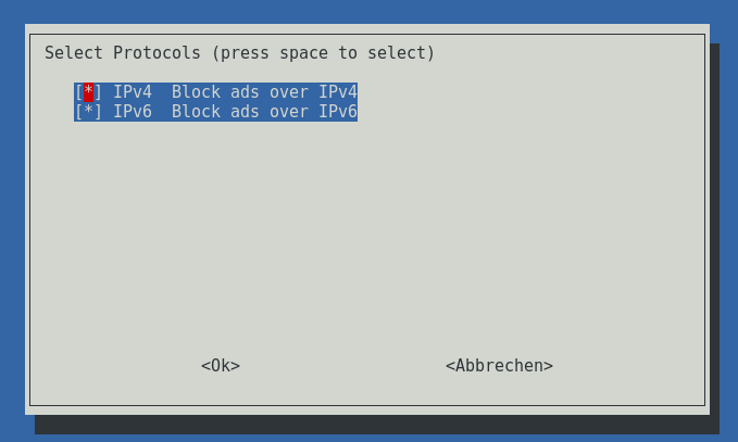

Thanks, it still looks like the IPv6 wasn't copied over during the 'reconfigure' process, /etc/pihole/setupVars.conf is showing a blank entry for where the IPv6 address should be. You can either edit that file by hand, adding in the IPv6 address for your Pi-hole and then run pihole -g to reparse and add the address, or try running the reconfigure again, and make sure that it give you the option for IPv6 blocking, and that its starred, and that it shows an IPv6 address in the next screen to confirm that it's doing full blocking on both protocols.

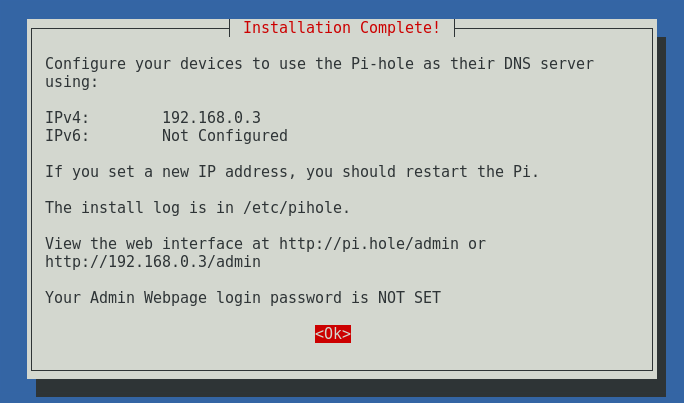

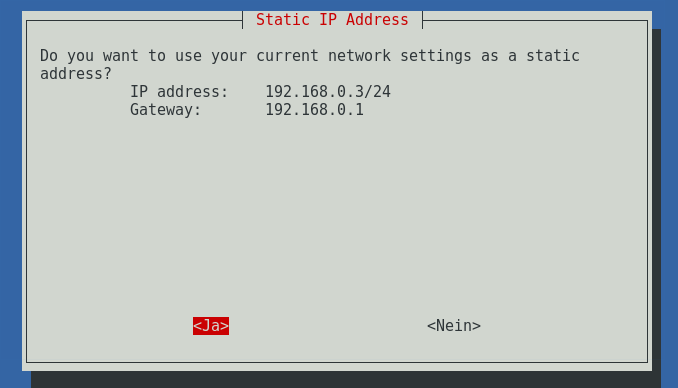

I reconfigured the Pi-hole again. Please found following the pictures from re-configuring:
I have no idea what's the IPv6 address of my Pi-Hole :frowning:

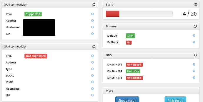

On a client machine, are you able to get a score on http://ipv6-test.com/ ?
For sure, I haven't a public IPv6 yet.
Okay, then you have a device on the network that is trying to get IPv6 DNS records, called AAAA records, but doesn't know that it will never reach the address. For now those hits in the panel can safely be disregarded, but I'll ask @DL6ER if he has any thoughts on how to resolve showing those, or if it's at all possible.
From the target address, I would think it may be the router that is doing the queries. Is it a Belkin router?
Edit: I see it's a Linksys, so it probably is the source of the lookups...
Yes it's a Linksys router, my target was to stop the router from "calling home".
In this case, it means that this queries not going to belkin?
