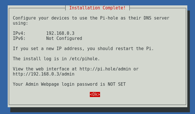

After much searching how to fix this problem, I accidentally stumbled across this fix for my own setup. Admittedly a new linux user, so I am not sure why this works for me. However, I was having the same issue as shown above (selecting both ipv4 and ipv6 where ipv6 would not enable) and I figured since the pi-hole was the first thing I installed on a Orange Pi Zero, I might as well start over completely, I re-configured the micro-sd card with the armbian ubuntu, and I forgot to sudo apt-get update or sudo apt-get upgrade and immediately installed the pi-hole. It may fail the install, but re-install again and it will fix the ipv6 enabling issue. Then you can sudo apt-get update and sudo apt-get upgrade. I have performed this action twice (I forgot how I fixed the issue the first time) and it worked both times.
