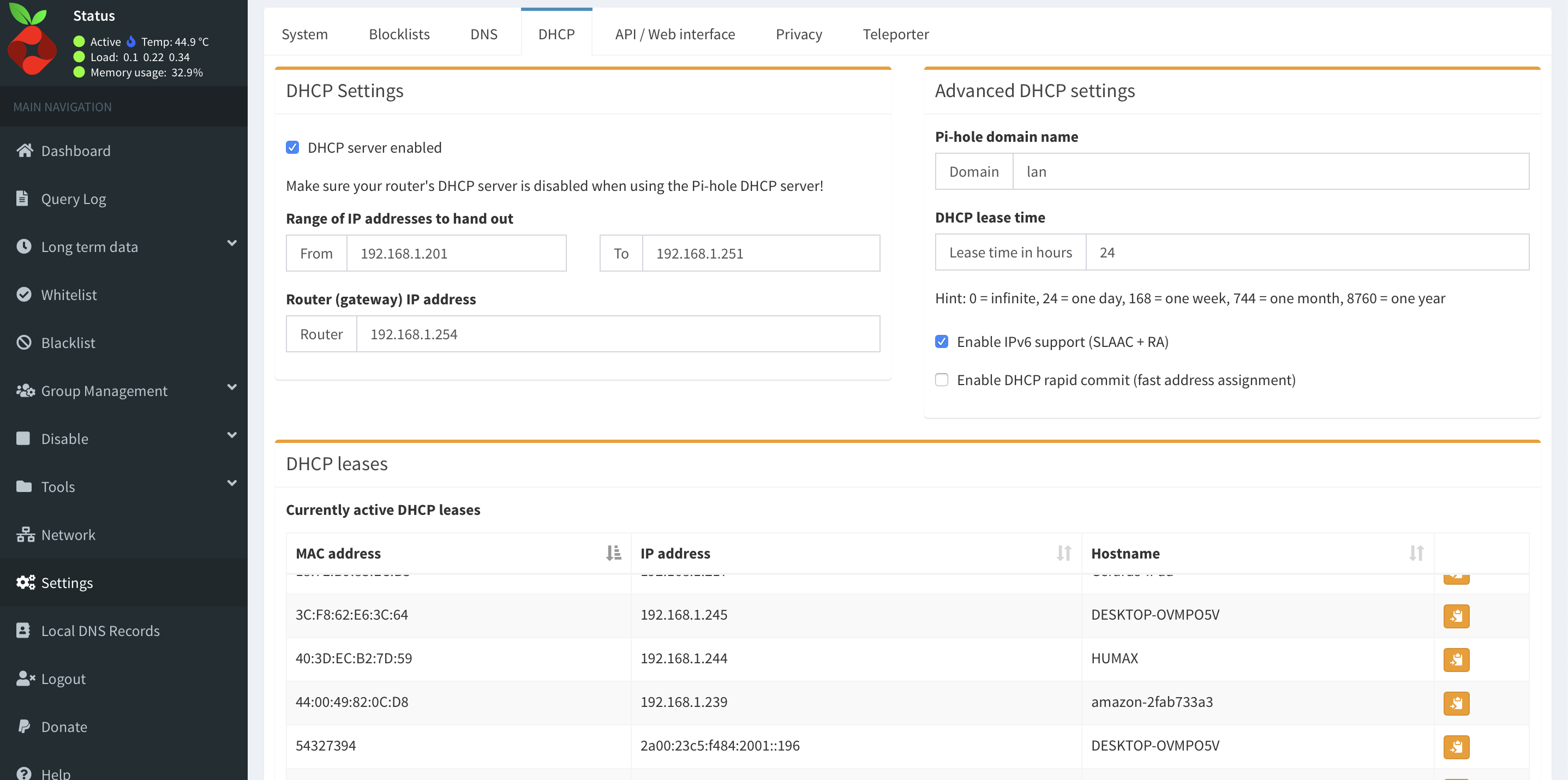

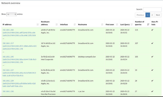

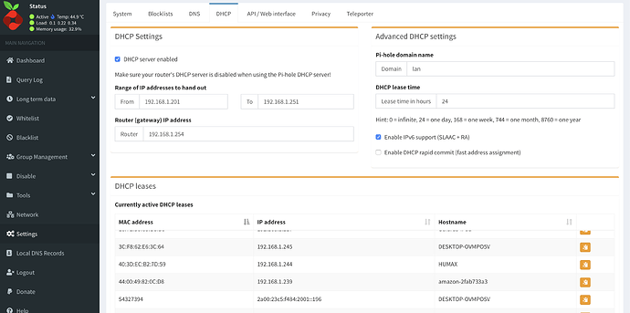

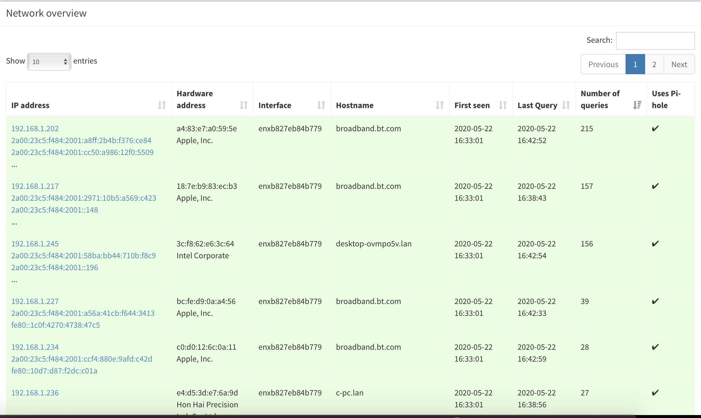

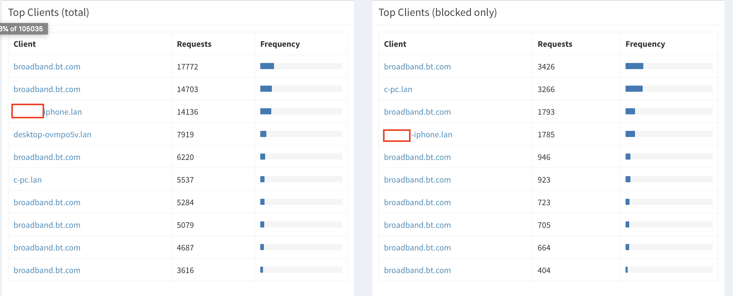

The dashboard lists any client using ipv6 to access the network as 'broadband.bt.com'. (see image). This is repeated into the network overview, which seemingly places 'broadband.bt.com' over the device's 'true' hostname (see image), despite this being visible within the DHCP config on the web interface (see image).
https://tricorder.pi-hole.net/pkom1orb8d
The network table uses the most recent hostname, and if new IPv6 addresses are being created and assigned via the router, then this is what the network table sees.

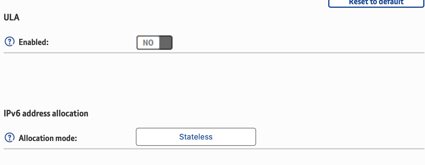

Sadly I do not have that ability - my ISP-provided router will not let me turn ipv6 off at all -the only configuration options relating to ipv6 are in the below image.
