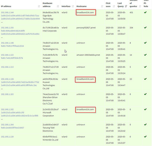

When looking at my network table - lots of the device that rely on the router for their wifi get identified as such (i.e. broadband.bt.com rather than say home-pc). this occurs with a few other devices as well that pass through the home router in some way (ethernet). I've tried flushing the network table through the gui and manually clearing the network table via the sudo command but the results are still the same.
Its almost like the system sees its coming from the router as the last hop so identifies the traffic via that hostname rather than delving deeper.

I'm pretty sure this is caused by the addition of support for IPv6 addresses on the network table. The network table uses the most recent (= the last used) IP address a client used to make a query to your Pi-hole when determining the host name. This might have been a GUA address such as 2a00:23c5:... for the three devices you pointed out.
I assume you're using conditional forwarding and/or specified your routers as upstream destination and it may be users your ISP's DNS server itself for IPv6 name resolution resulting in broadband.bt.com as reply.

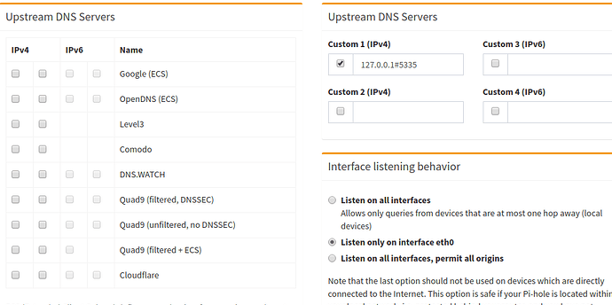

P.S. Did you
for your pihole?
Nope - as my Pi-hole acts as DHCP so I didn't think that would be required?
I was referring to upstream DNS (not DHCP). What did you put here:

Ah - in that case no. I'm using Cloudflare and google. I suppose I could use the router as a secondary IPv4 source
Strange... no conditional forwarding and not the router as pihole's upstream DNS. But might be related to IPv6 anyway..
