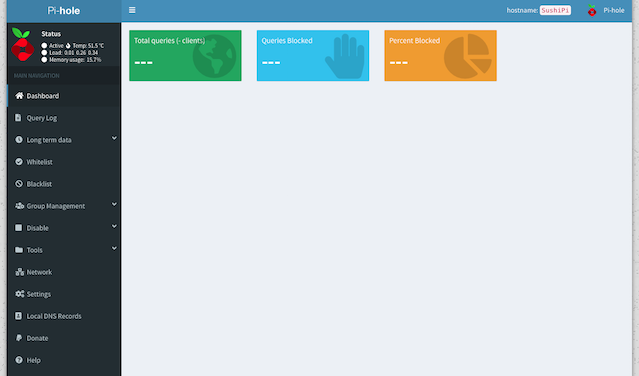

Incomplete dashboard after updating to V5.0
Update from latest 4.x run fine, DNS server and adblocking are working, but can't access admin interface.
On RPi 3B+ running latest Diet-Pi 6.30 (update fresh from this morning !)
Tested on Mac & Windows w/ Safari & Firefox (AdBlock origin checked)
uname -a
Linux SushiPi 4.19.66-v7+ #1253 SMP Thu Aug 15 11:49:46 BST 2019 armv7l GNU/Linux
apt-get update && apt-get upgrade && pihole -up && dietpi-update
-> everything up to date
tryed :
pihole -r & pihole -g -r
But still won't work.
