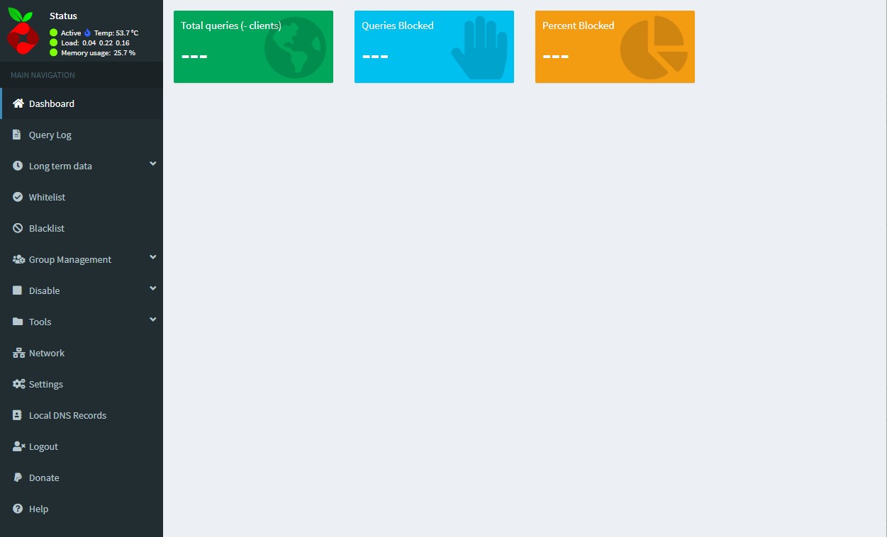

See no stats after update to 5.0
When i on the Mainpage of pihole i see the query diagram and stats of blocked ads
i see nothing
Extra informations
i use nginx as webserver

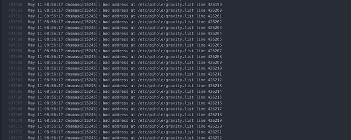

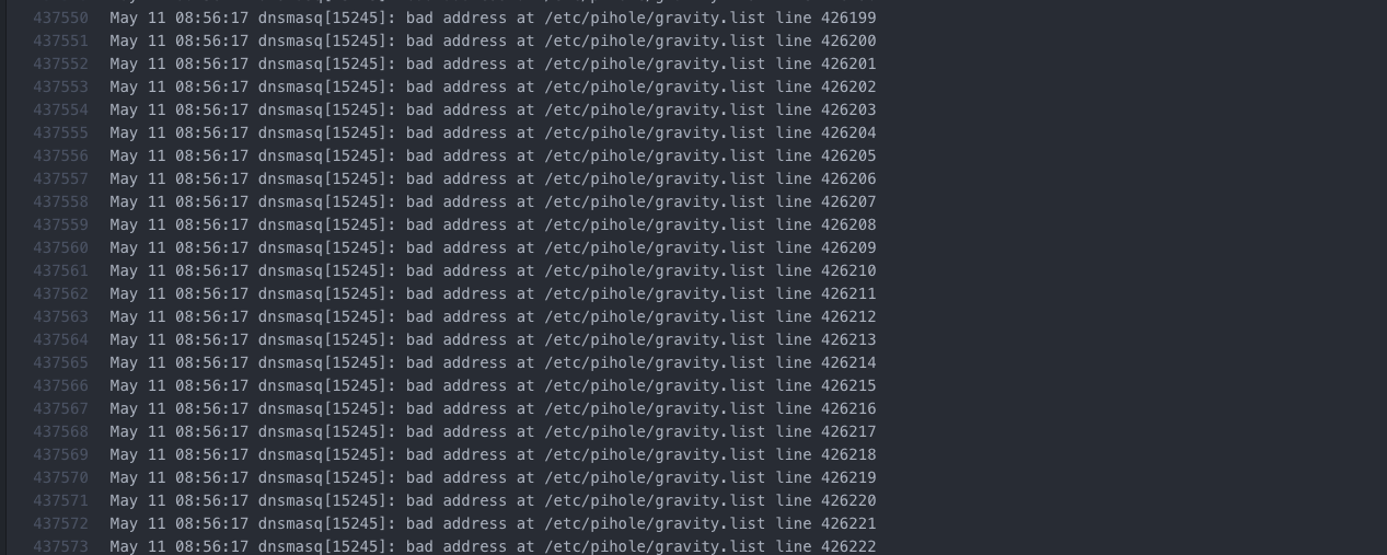

> May 11 08:56:17 dnsmasq[15245]: bad address at /etc/pihole/gravity.list line 426705
https://tricorder.pi-hole.net/0o3iyhc9h1
With the command
awk 'NR==426705' /etc/pihole/gravity.list
you can check that line.
Thanks, but my hole pihole.log looks like this
That's why I think it's a problem with the gravity.list

Hi guys, everyone who did not choose to install Lighttpd within Pi-hole installer needs to do:
usermod -aG pihole www-data
apt install php-intl # Respectively the package matching your PHP version, like php7.3-intl
I just got the idea to view the error log from the webserver:
[Mon May 11 20:33:50.704422 2020] [php7:warn] [pid 3039] [client 192.168.1.60:56525] PHP Warning:  Use of undefined constant SQLITE3_OPEN_READONLY - assumed 'SQLITE3_OPEN_READONLY' (this will throw an Error in a future version of PHP) in /var/www/html/admin/scripts/pi-hole/php/database.php on line 61, referer: http://192.168.1.2/admin/network.php
[Mon May 11 20:33:50.704669 2020] [php7:error] [pid 3039] [client 192.168.1.60:56525] PHP Fatal error:  Uncaught Error: Class 'SQLite3' not found in /var/www/html/admin/scripts/pi-hole/php/database.php:42\nStack trace:\n#0 /var/www/html/admin/scripts/pi-hole/php/database.php(65): SQLite3_connect_try('/etc/pihole/pih...', 'SQLITE3_OPEN_RE...', true)\n#1 /var/www/html/admin/api_db.php(56): SQLite3_connect('/etc/pihole/pih...')\n#2 {main}\n  thrown in /var/www/html/admin/scripts/pi-hole/php/database.php on line 42, referer: http://192.168.1.2/admin/network.php
Then I checked if php-sqlite3 is installed, which was not the case. After a webserver restart it worked again.
Edit:
New problem: When I want to edit the groups While executing: **attempt to write a readonly database**
Please open a new topic for this problem, so the existing topic for the original issue can continue.
The issues have the same source, hence I would not separate. In case of OP it is expected since Nginx as webserver means that INSTALL_WEB_SERVER=false is set which again means that the installer/updater does not add www-data to pihole group, preventing database write access, and no PHP modules are installed, leading to missing SQLite and intl modules. Although in case of SQLite it is strange since this was used/required before already :thinking:.
