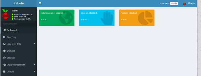

Problem with Beta 5.0:
"Unable to complete update, please contact Pi-hole support."
w38f7gjijn
Your FTL branch did not update to 5.0:
[✓] FTL: v4.3.1 (https://discourse.pi-hole.net/t/how-do-i-update-pi-hole/249)
You are also running an unsupported OS (Stretch and Buster are currently supported, Jessie is EOL and not supported). This may be contributing to the problem.
[✓] Raspbian GNU/Linux 8 (jessie)
