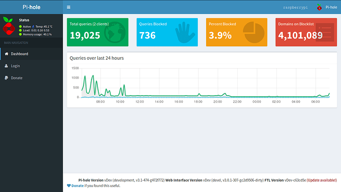

I have slightly reduced the size of https://smokingwheels.github.io/Pi-hole/allhosts

It contains a bunch of malware, ad, coin, and tracking domains. I found that if I use all of these lists independently, my pi-hole box stops blocking ads, not sure if this is due to an upper limit (approx 1.3M sites) or something else.
@mildocjr The lists do contain a lots of IP addresses and the Pi-hole only blocks domains so you would see ads if you ran them independently.
