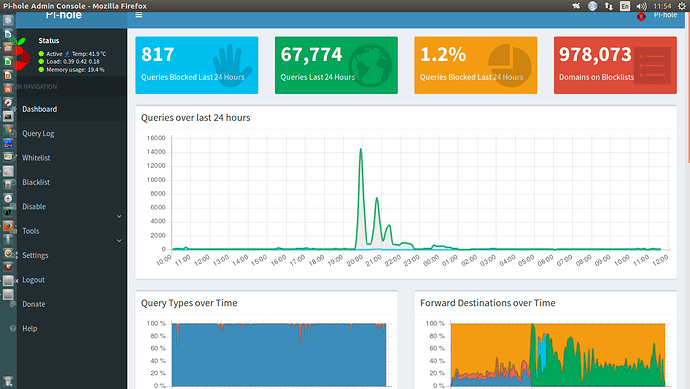

The Actual number on a clean Pi-Hole is 978022 Domains on BlockList I may update with a few more like the pic after testing.
