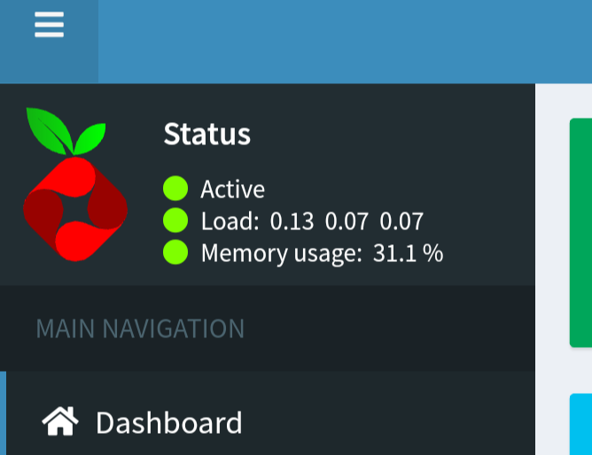

Status
Clear the browser cache and reload the dashboard.
remains the same, does not load the temperature

Please generate a debug log with pihole -d and post the token here. What OS and plattform are you running pihole at? The only time this has been discussed here is quite a while back
how it works so that the temperature appears on the panel?
It will not make the temperature to show up, but will help us to troubleshoot your issue.
but its performance is affected?
If you want help resolving the problem, please provide us the information we need to help you.
How can I verify that it is working correctly?
Run pihole -d and read the output.
https://tricorder.pi-hole.net/yg88vupoi9/
You're running pihole on Ubuntu. As in the other thread mentioned, the temperature is not displayed on ubuntu systems (if things haven't changed in the meantime).
