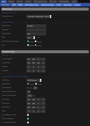

Note that my main network is 192.168.1.1 (br0).
I also have a public wireless network set on 192.168.10.1 (br1).
My PiHole is connected on Port 3 behind my router.
In Setup > Basic, I set Static DNS 1 to 192.168.2.2. I did not check "Use DNSMasq for DNS"
In Setup > VLANs, I assigned Post 3 to VLAN 3 (which wasn't used).
In Setup > Networking I set the Port Setup VLAN 3 with the following:
Bridge Assignment: Unbridged
Masquerade/NAT: Enable
IP: 192.168.2.1
Mask: 255.255.255.0

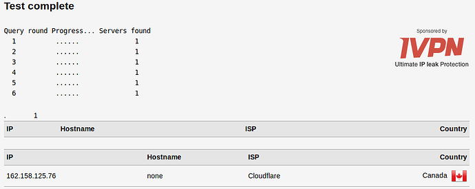

Since I'm using DNS over HTTPS, a DNS leak test would reveal multiple servers if this wasn't working.

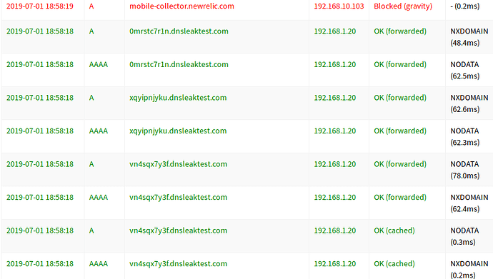

I tested by setting my Static DNS server on my computer to 1.1.1.1.
$ nslookup duckduckgo.com
Server:		1.1.1.1
Address:	1.1.1.1#53
Non-authoritative answer:
Address: 107.20.240.232
Address: 184.72.104.138
Address: 23.21.193.169
the PiHole catched the request for duckduckgo.com
DSN Leak result:
The PiHole catched everything.
