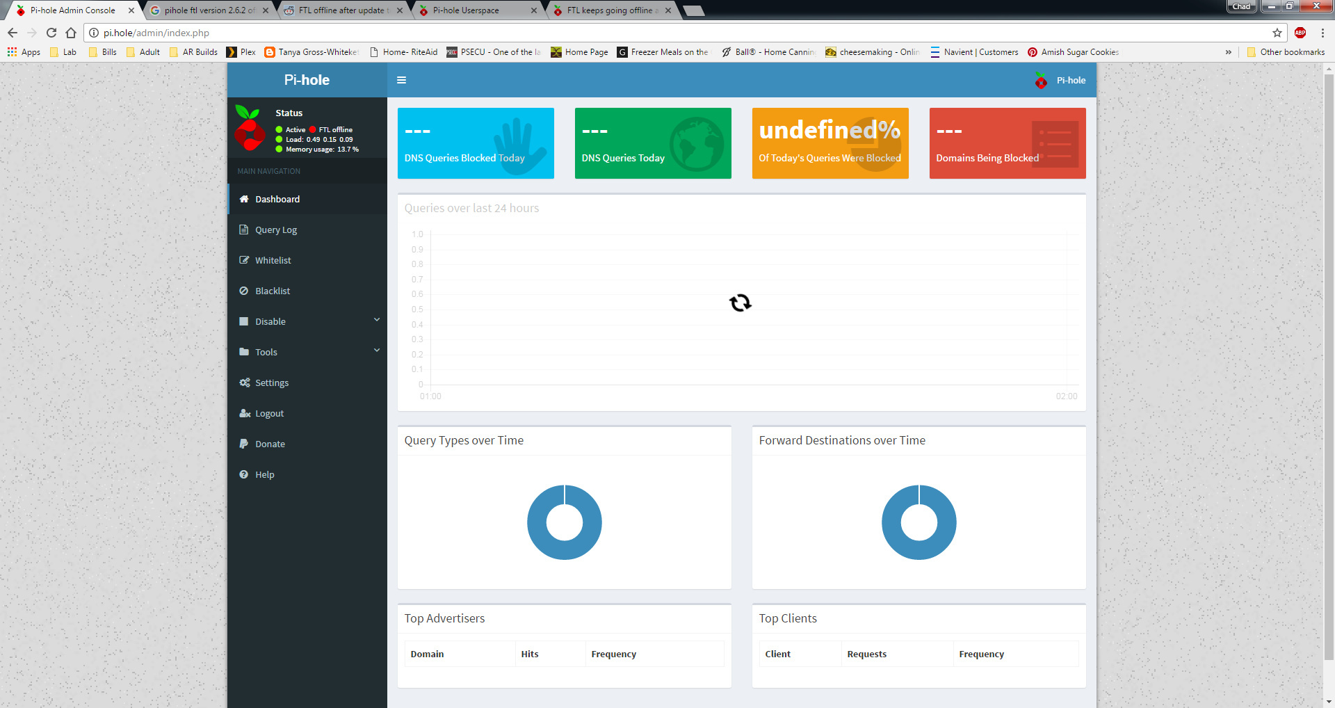

I found it necessary to do an uninstall and reinstall moving to using FTL.
Just to add to that: I suspect in the end part of the problem was a browser caching issue. Even after uninstalling and reinstalling, the dashboard screen was not rendering properly. After I blew my cache in Chrome away everything rendered properly.

Try deleting your cached files in Chrome. No need to delete cookies.
