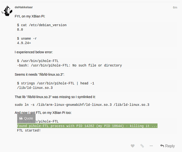

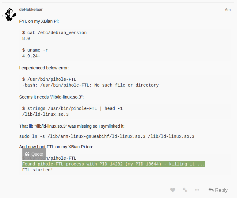

FYI, on my XBian Pi:
$ cat /etc/debian_version
8.0
$ uname -r
4.9.24+
I experienced below error:
$ /usr/bin/pihole-FTL
-bash: /usr/bin/pihole-FTL: No such file or directory
Seems it needs "/lib/ld-linux.so.3":
$ strings /usr/bin/pihole-FTL | head -1
/lib/ld-linux.so.3
That lib "/lib/ld-linux.so.3" was missing so I symlinked it:
sudo ln -s /lib/arm-linux-gnueabihf/ld-linux.so.3 /lib/ld-linux.so.3
And now I got FTL on my XBian Pi too:
Found pihole-FTL process with PID 14282 (my PID 18644) - killing it ...
FTL started!
