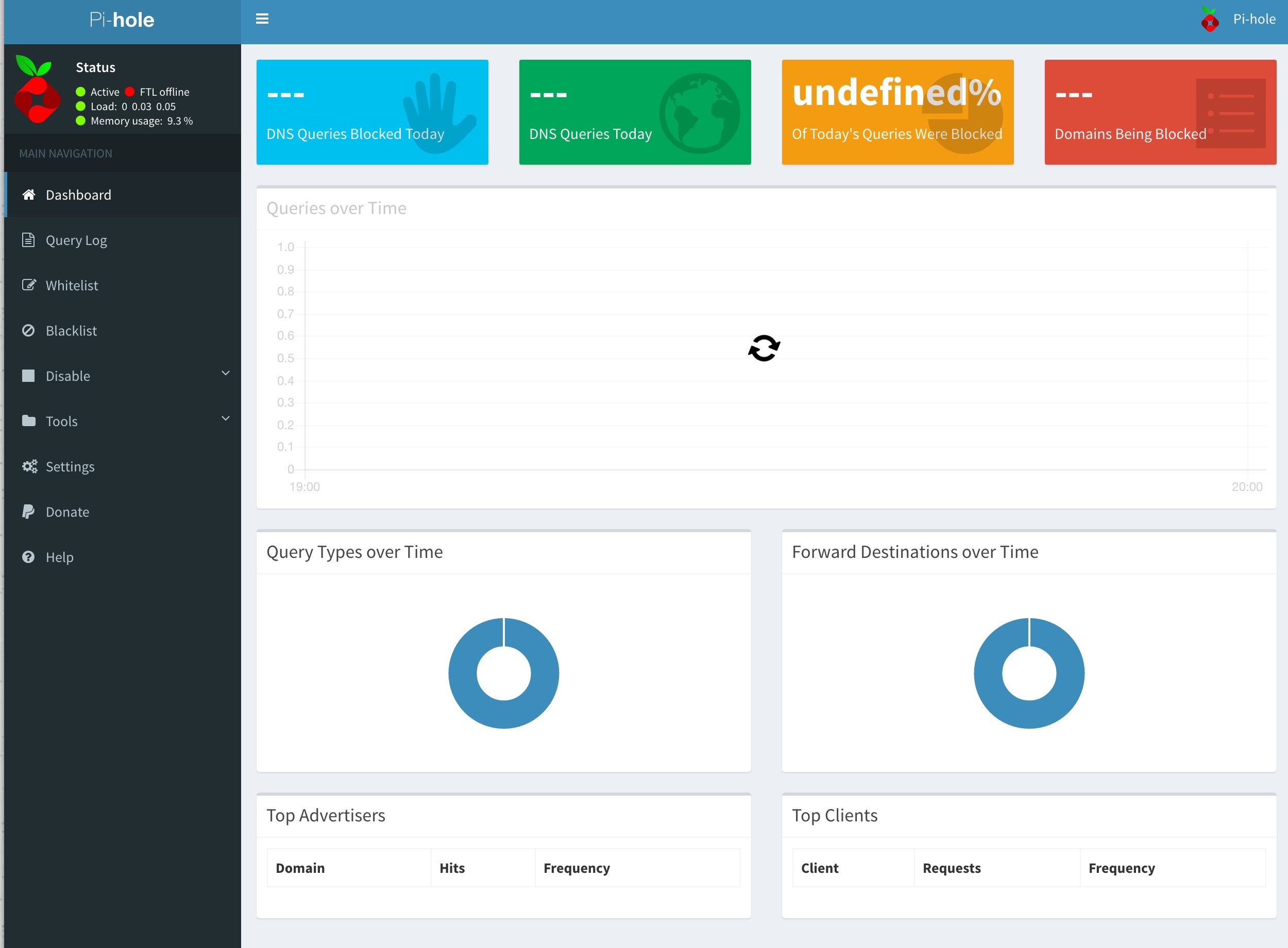

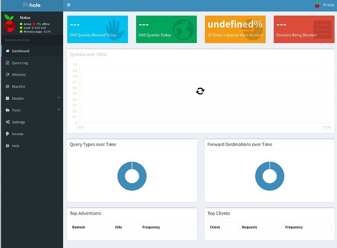

When the FTL goes down, it seems the whole web interface also doesn't work properly:

Same issue here. I updated from master branch to 3.0, blocking is enabled. But no web interface. All the settings were at default while updating. Port 4711 is configured correctly for FTL.

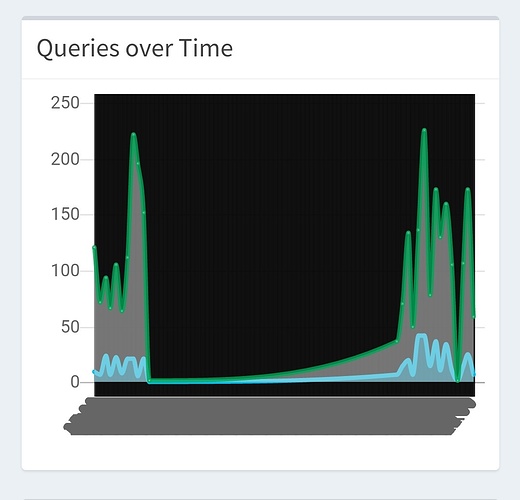

Now the web interface is running. But when I open dashboard on Chrome, it consumes ~500MB of RAM and it is very slow. Also graph is

This looks like your browser still caches the JavaScript of earlier times. Unfortunately, most users won't flush the JS cache, even if you request to clear all browsing data...
Try closing the browser altogether and restarting it.
Another possibility is to go to the "Developer Tools" (press F12), go to "Network" and select "Disable cache" (might be named differently depending on your browser). Then reload the web interface of Pi-hole and keep the Developer Tools opened. The first loading might be slow (because no caching will be done), but hopefully it works in resolving your issue.
I also suspected​ the same thing, I cleaned the cache. But nothing happened. I uninstalled and reinstalled pihole, now everything is working fine. However it's showing 'queries over time' graph only and graphs (pie chart) about 'query types' and 'forward destinations' are missing....
