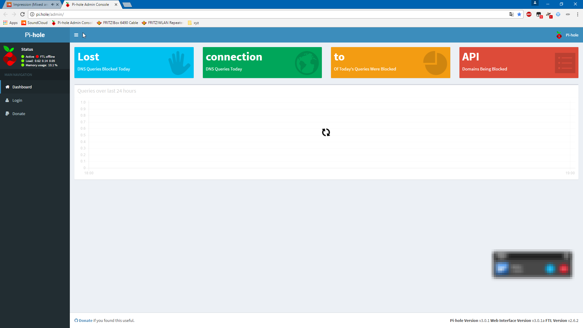

FTL keeps going offline after update to 3.0
same FTL is offline
a reboot -h now fixed it
i just wonder why the api went offline

Now FTL is back offline with a fresh install of 2017-04-10-raspbian-jessie-lite onto a USB drive (on Rpi3 with USB boot enabled). pihole updated to FTL 2.7, and it's immediately offline, lost connection to API. Tried a hard reboot (unplug) and reboot -h all with no luck.
Pi-hole Version v3.0.1 Web Interface Version v3.0.1 FTL Version v2.7
