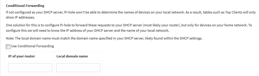

Doesnt matter really but a little bit more work if set router to do DHCP.
Only the router gets to know the client hostnames through the DHCP process/renewal:
Surely must be but am not familiar with OS X.
