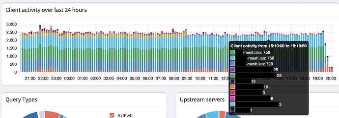

One of its functions is to find and identify devices on the network so they can be presented in the Velop app. Each node makes tens to hundreds of PTR requests every minute to the network's DNS server. Normally this traffic would not be visible because it would be handled by the router's DNS server.
Pi-hole can be configured in different ways but one common approach is to ammend the router's DHCP to stop using the router for DNS and switch to using Pi-hole for DNS. Another common approach is to disable the router's DHCP entirely and enable Pi-hole's DHCP to replace it. This way Pi-hole always presents itself as the DNS server.
Either way, with Pi-hole as the DNS server, Pi-hole users will now see all the Velop PTR traffic. These swamp the Query Log and graphs and make them difficult to use for other devices on the network.

Use Pi-hole's Dashboard graph to identify how many nodes are flooding it with PTR queries. Find these nodes in Tools > Network and make a note of their MAC addresses. You will probably find that the Velop parent node is not sending PTR requests, it is just the child nodes.
So if you have, eg, 4 Velop nodes, 1 is set as parent and the other 3 are child nodes, you would only need to configure those 3 nodes in the next section. This is my friend's graph and you can see the 3 child nodes dominating the graph.
