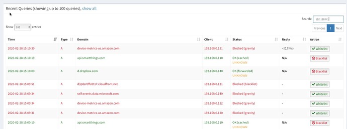

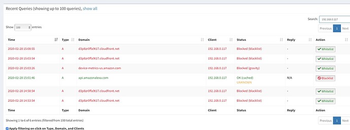

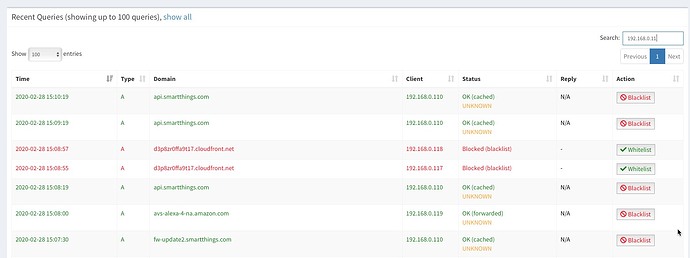

When using the Query Log Search field, I can't seem to search explicitly, even with quotation marks. For example I want to filter/search for IP 10.0.1.6, but instead I'm getting 10.0.1.6*, where the * is all other numbers as well.
Is there a way to do this through the admin console or must I use the terminal? Thanks.
Are you seeing all the other IP's, or only those IPs that lead with 10.0.1.6 (i.e. 10.0.1.6, 10.0.1.61, etc.).
Just ones that lead with 10.0.1.6, so for example 10.0.1.69 and 10.0.1.6

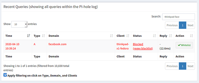

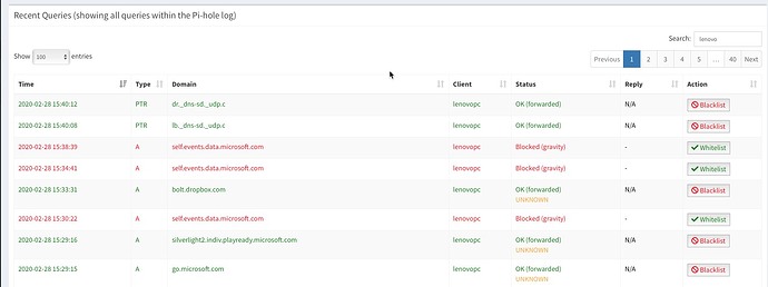

Well, everything the on-click does is copying the current text into the search box on the top right. Would you like to change the search behavior to need to be exact? I'm pretty sure we'll loose more functionality than we get.
For instance, you can now type: google and the search result will be all domain containing google somewhere in their name.
If we change this to exact search, such a thing will not be possible any more. For instance, using our "smart" search algorithm, you can currently put multiple constraints at the same time, e.g.,
where I searched for a client + domain contribution. Both only in parts.

What I did was decoupling filtering and searching as this made things cleaner. As it is not immediately obvious what is now being filtered on, we show this in the reset button.

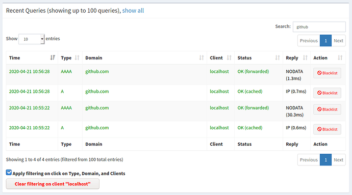

What you can do now is:

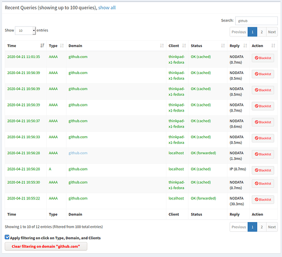

  1. Click on an item (query type, domain, client) to filter exactly on this item (clicking on github.com will not show collector.github.com)
    Probably a better example is that clicking on A doesn't show any AAAA queries any longer:

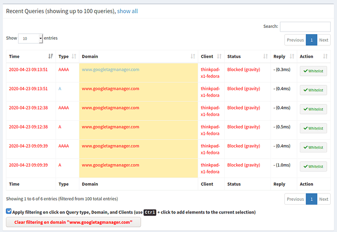

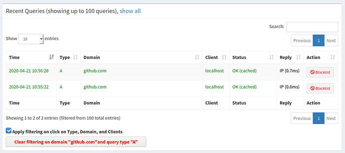

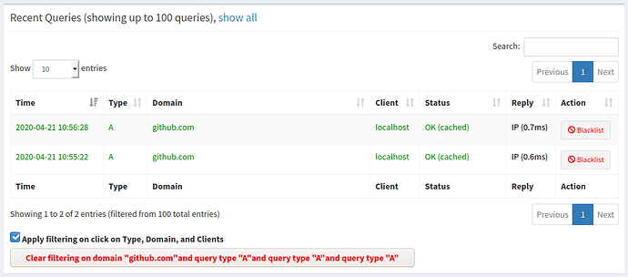

  2. You can combine filtering when you hold [Ctrl] when clicking, the reset button text will again tell you what you did:
    It is possible to add the same field multiple times to the filter, this will cause no issues, even when it doesn't make too much sense:

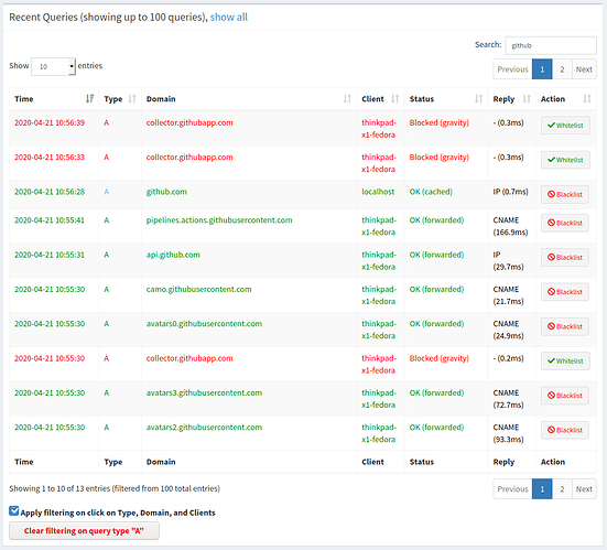

  3. Searching works on top of this filtering, for instance, you can still get all *.github.com requests from an exact filtering on a specific client by clicking on the client and then entering github into the search field:
  4. Clearing the filtering does not empty the search field any longer as filtering is now separate from searching.
Testing would be highly appreciated as such a fundamental rewrite is likely to have some side-effects I have not yet considered.
edit: I already added the missing space in front of the and in the button seen in the screenshots above.

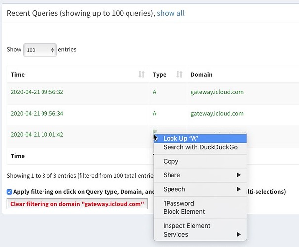

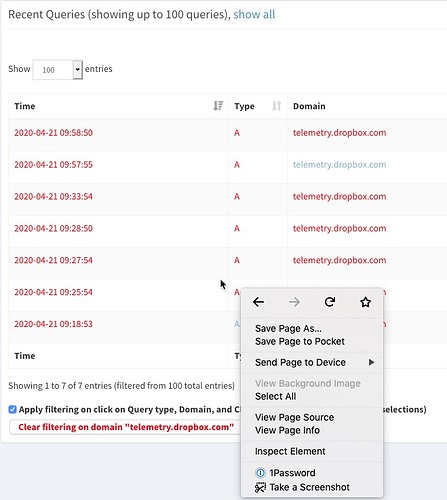

I cannot get this to work on any Mac browser. The OS or browser intercepts the Ctrl key combination with popups. Works fine on a PC. I tried alternate key combinations on the Mac with no success.
Firefox Mac:
Safari Mac or Chrome Mac (same behavior):
