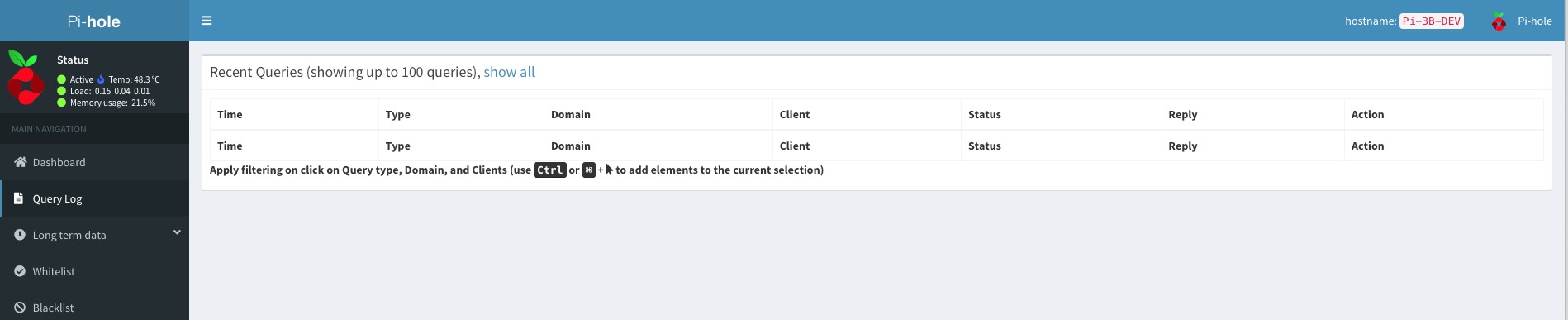

I also changed filtering to work only on Ctrl/Command + click (add columns) and Shift + click (remove columns).
The checkbox is gone.
The hint text needs to be updated, still, also to mention that you can get something from Shift + click as well. Suggestions are welcomed.
It's really great now!
I don't see any hint text (mouse over) at the moment. How flexible is this - can it be specific for every column? You could use "Command + Click to add this Type/Domain/.... to the filter". If there is already a filter for column say "Shift + Click to remove this Type/Domain from the filter".
For regex the mouse over must contain two lines; the one already in place ("Click to show matching regex filter") and one of the above.
At the end of the table.
"Filter for Query type, Domain, Clients, Status and Reply
  • use Ctrl or ⌘ + Click to add elements to the filter
  • use Shift+ Click to remove elements from filter

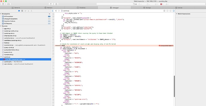

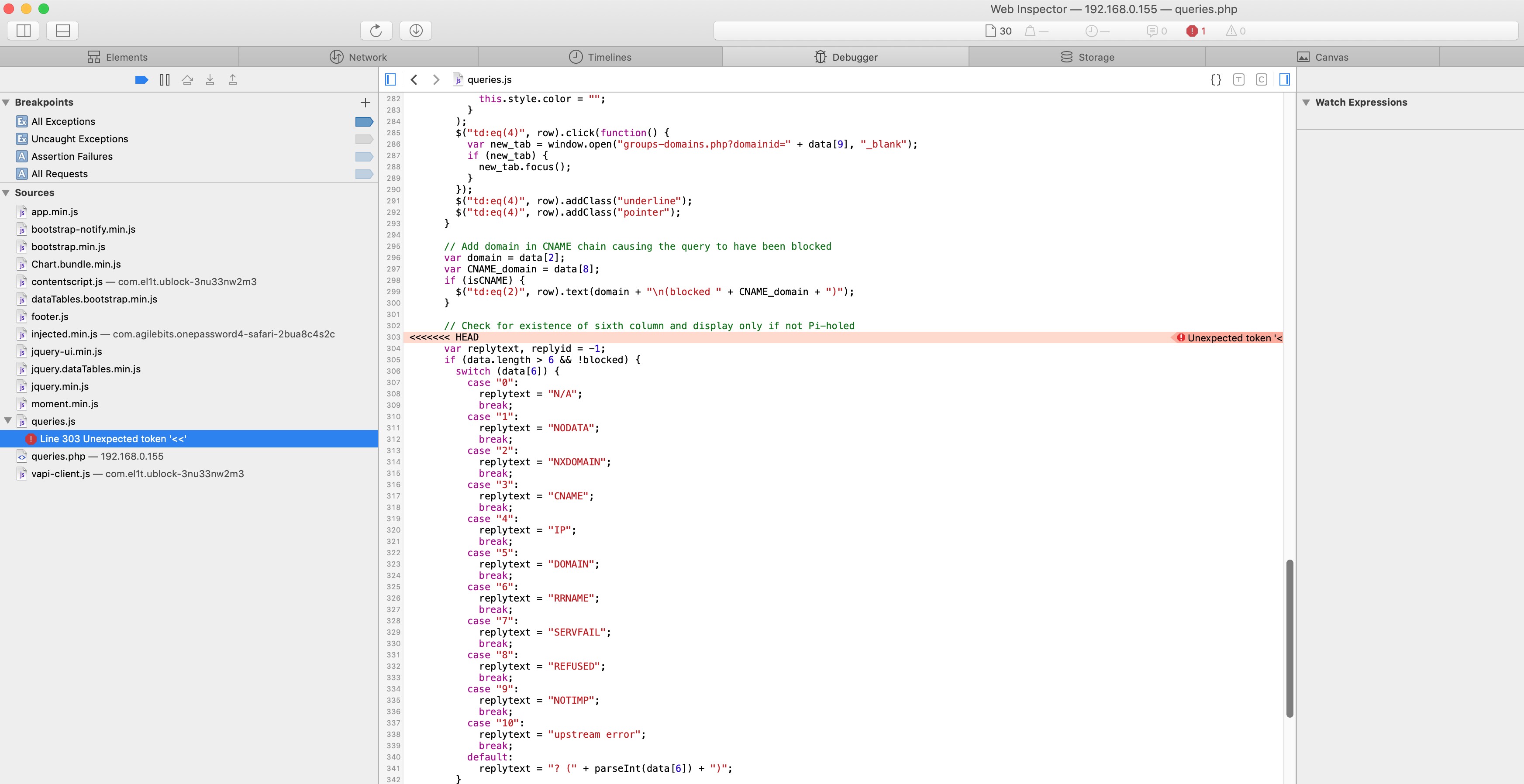

On my Mac, I now see nothing in the query log:
Reverting web back to Release 5.0 beta resolves it and the query log is back.
Is there anything on the Developers Console?

This is the only error showing. I cleared the browser cache prior and reloaded the page. No change from previously.
