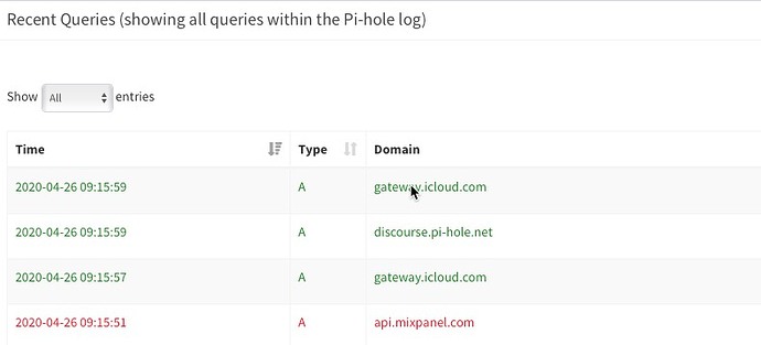

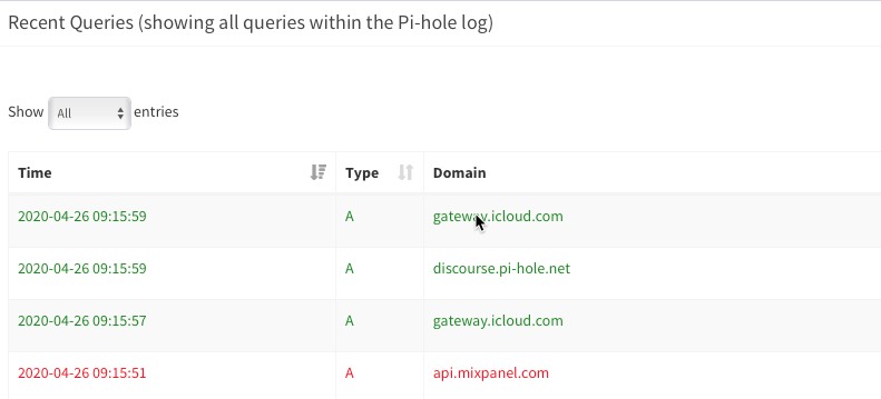

No select hand when I mouse over a selectable element - just the normal pointer and no ability to select that element for filtering:

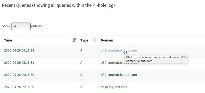

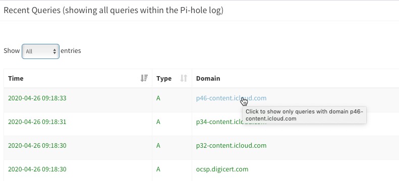

On the beta branch (not the tweaking branch), the hand is operational:
I have cleared cache and cookies for the Pi-hole URLs and restarted the browser with no effect.

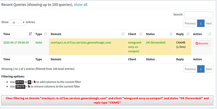

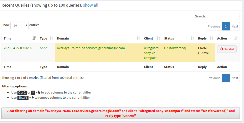

I would suggest to also change the description of the "Clear Button" from "Clear filtering on domain xx and type yy... and....." to just "Clear all filters"

Since you implemented the highlighting I think it is very clear what is filtered on. The button therefore gives no additional information. But it can look a bit....clumsy and overwhelming.
Addition
"remove columns to the current filter" --> "remove columns from the current filter"
