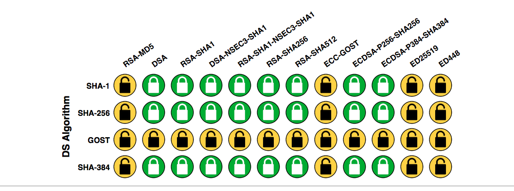

I just had a conversation with @DL6ER about DNSSEC, after finding this website, that allows you to run some test. On the right side of the page, there is a box ‘further connection testing’ with the ‘DNSSEC resolver algorithm test’.
Running the test, with dnsmasq as the DNSSEC evaluator gives this result:
If you run your system with only dnsmasq (or FTLDNS), so no unbound, dnscrypt-proxy or stubby, you should at least get this result, otherwise you're using resolvers that handle DNSSEC incorrect.
It turns out, implementing this unbound solution, and having the DNSSEC evaluation performed by unbound, delivers a far better (more green) result. This implies you need to turn off the DNSSEC evaluation for dnsmasq, using settings.

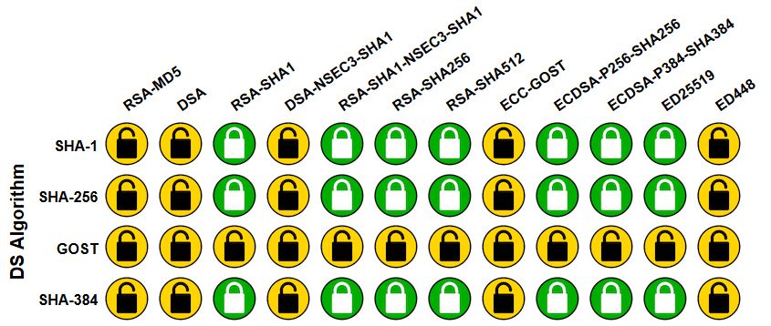

Here are my results for pihole+stubby
My setup: Pi-hole (FTLDNS) -> dnscrypt-proxy -> dnscrypt.me
with enabled DNSSEC in Pi-hole: same as in screenshot by jpgpi250
with disabled DNSSEC in Pi-hole: same as in screenshot by gecko

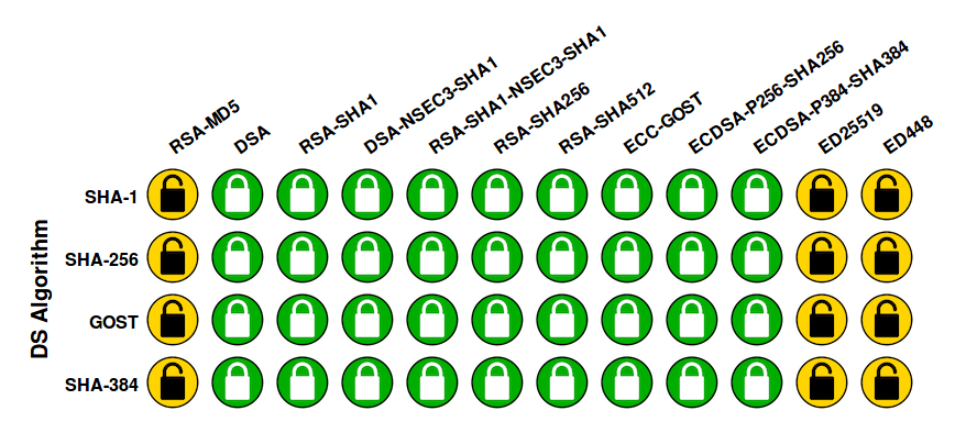

For the sake of completeness, I will add the result of unbound + Pi-hole (as described in our official guide) here as well:
Note that RSA-MD5 is considered highly insecure and is marked as "must not implement" in RFC 6944.

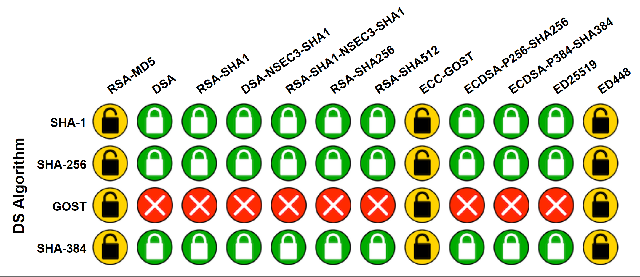

Just to add, here's what I currently have now with Pi-hole w/ FTLDNS + dnscrypt-proxy using Cloudfare.
