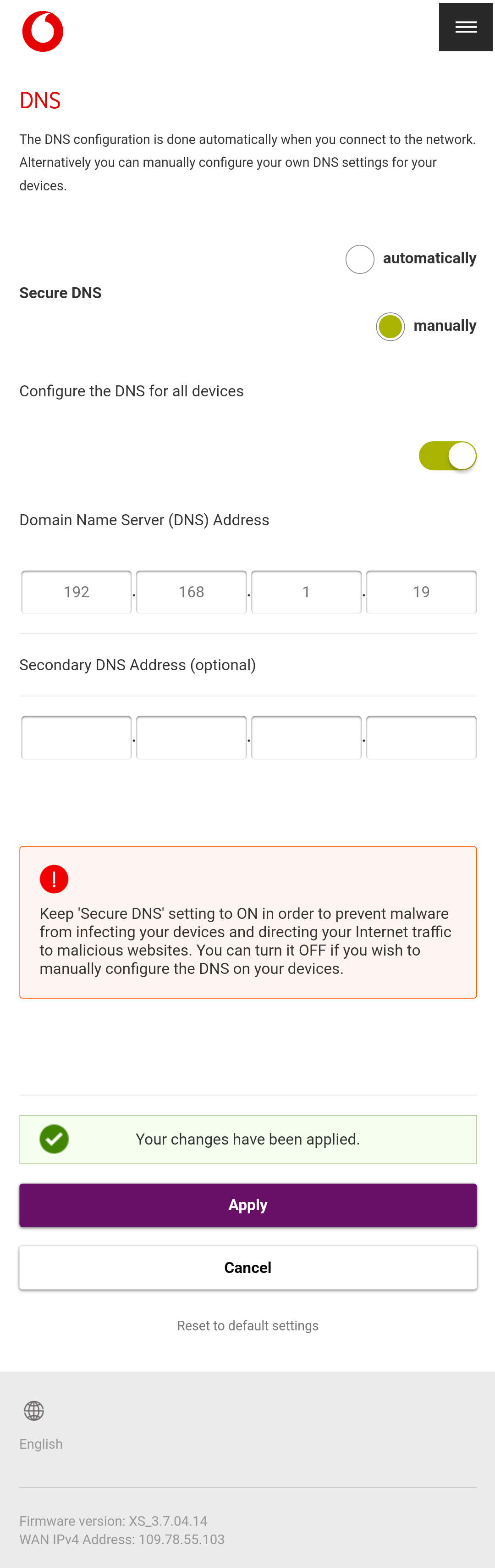

I have a Vodafone gigabox router. Dns settings are as follows (192.168.1.19 is the ip for my raspberry pi)
If those are the only DNS settings in the router, they appear to be for the WAN side.
Which explains why your router WAN IP (your public Internet IP) appears in the Pi-hole logs.
Plus it explains the warning you received.
What is preferred and described in the docs is to have the DHCP service for your LAN (currently active on your router) to advertise the Pi-hole IP to its clients for DNS resolution.

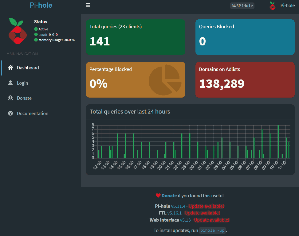

You are still running an open resolver, i.e. your Pi-hole is open to misuse:
To stop that, close port 53 on your router immediately (and maybe port 80 as well).
Oh that was the AWS version I had initially set up, it was open (in error). I have terminated it now, so all good.
