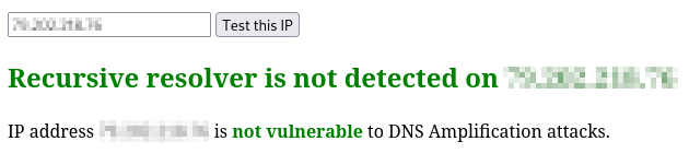

These are the results from https://openresolver.com/ providing my public IP. So I suppose I am safe?!
As long as you are not seeing the Pi-hole interface and you do not have port 53 forwarded from your modem to the Pi-hole server then you're fine.
That recursive resolver test is a great way to check. You can also use an online port checker to see what ports are open. The key port is tcp/udp 53.

Good hint, cheers! All popular ports (FTP, HTTP/S, SSH, TELNET, ... whatnot) are closed as well as another good fraction of ports the online tools contained in their checks. Glad I double checked phew

FYI, combining both ifconfig.me and test.openresolver.com:
dig +short @$(curl -s ifconfig.me) test.openresolver.com txt

Indeed, I had been running a version query as well as one similar to test.openresolver.com as posted by deHakkelaar in order to verify that a Pi-hole installation was accessible at the public IP address.
The curl confirmed that specific IP to belong to their router, and thus an open resolver.
