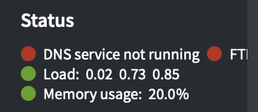

As far as memory goes this is with DNS Service not running:
I ran pihole -r (now seeing an error that says pihole-FTL: no process found)
and it's taking some time on "Restart DNS Server..."
