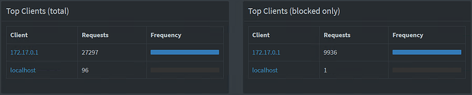

Hi, I have tried to find the answer to this issue but I feel the answers all for slightly differnt issues.
My setup: I use by router fritz.box as DHCP with DNS pointing to my pihole.
it works perfectly, all DNS traffic goes through the pihole
however, I cannot see any clients on the dashboard or under group managment/clients
I feel this is a docker bridging issue, but reading about using docker in hosts mode and swarms appears overly complicated for what I need.
Here is my debug: https://tricorder.pi-hole.net/fi2m33t94b
I would appreciate being able to see all the hosts on my network instead of just the router
Many many thanks
Pete

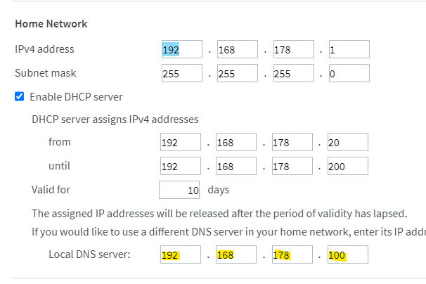

HI there
I have distributed PiHole IP via DHCP for local clients
See below, my DHCP setting on the router where 192.168.178.100 is my pihole
I have also fixed the Pihole address so it does not change
thank you
