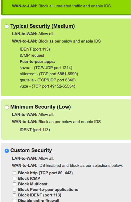

Edit: here are some of the Arris firewall options, customer to Medium, as High wouldn't fit in the screenshot:
Having iptables on the Pi to block network traffic to alternate DNS servers is not going to be effective. The DNS traffic only goes to the Pi (Pi-Hole) if the client has the DNS address. If not (i.e. hard coded to use another DNS), then the requests go directly from the client to the router and off to the internet, and the Pi (Pi-Hole) sees none of it.
For a DNS redirector to be effective, it has to be on the router (the only piece of equipment in your setup that sees all the traffic to the internet).

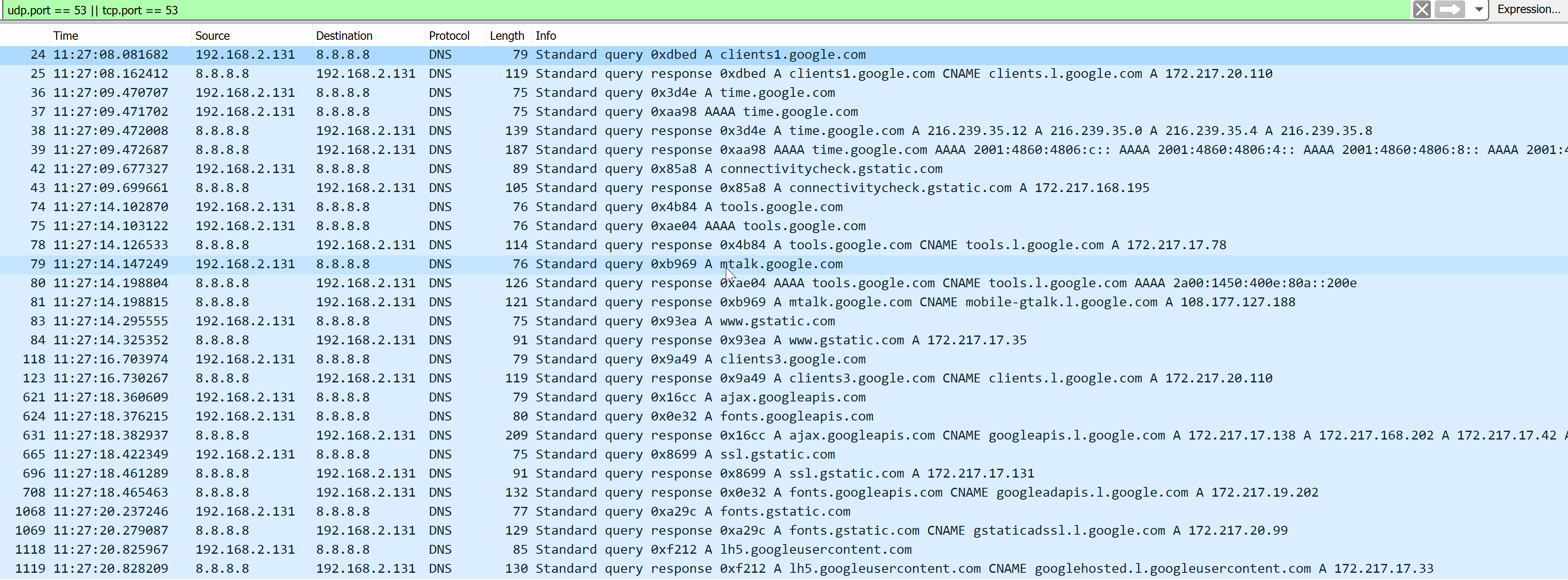

I have a chromecast, DHCP provides the DNS server (pihole), but the chromecast simply ignores the DHCP provided DNS server.
This is what happens if I simply power on the chromecast, up to the moment the first picture appears on screen (chromecast IP 192.168.2.131):
As you can see, the chromecast simply ignores the DHCP provided DNS server and uses the hardcoded 8.8.8.8 (google DNS server).

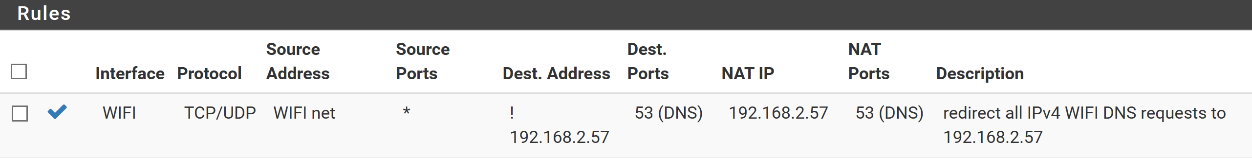

Because I have a NAT rule on the firewall, everything going to 8.8.8.8 is redirected to the pihole. The rule applies to all devices on the WIFI adapter and the destination is NOT the pihole (192.168.2.57). Some other devices are actually using the DHCP provided DNS settings, so redirection is NOT required.
Warning !!! In this example, the pihole is on a different physical network (wired - ethernet), this rule will NOT work if you are using pihole on WIFI. The pihole will NOT be able to resolve DNS requests.
As a result, the firewall intercepts all DNS requests from the chromecast and redirects them to the pihole. In the pihole log (/var/log/pihole.log) the following entries are logged, proving the DNS requests are redirected:
