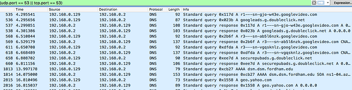

I've posted results from a few minutes of the suggested command sudo tcpdump -npi eth0 -vvv host 192.168.0.2 and port 53 on my Pi.
The Pi IP address is 192.168.0.2. The Chromecast is 192.168.0.250. I have this
route -n
Kernel IP routing table
Destination Gateway Genmask Flags Metric Ref Use Iface
0.0.0.0 192.168.0.1 0.0.0.0 UG 202 0 0 eth0
8.8.4.4 192.168.0.2 255.255.255.255 UGH 0 0 0 eth0
8.8.8.8 192.168.0.2 255.255.255.255 UGH 0 0 0 eth0
192.168.0.0 0.0.0.0 255.255.255.0 U 202 0 0 eth0
But the Chromecast IP, 192.168.0.250, is not showing in the tcpdump.

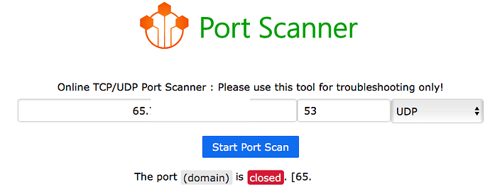

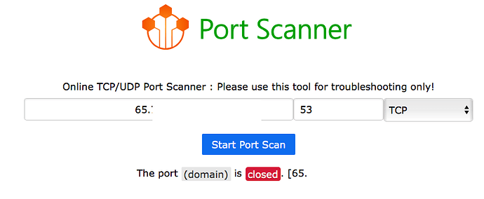

I don't see any traffic going to 8.8.8.8 nor 8.8.4.4. I have an Arris cable modem so I had to configure DNS to point to the Pi, and I enabled Port Forwarding so UDP port 53 goes to the Pi IP which is 192.168.0.2.
