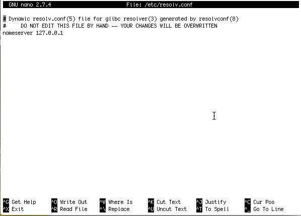

The edit command is sudo nano /etc/resolv.conf
Here is a screen shot of what you should see when you run the editor:
no mine is empty. just the bottom text.
Shall I write it and save it?
It worked. Now we are back to problem No1 how to set up the DNS.
