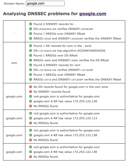

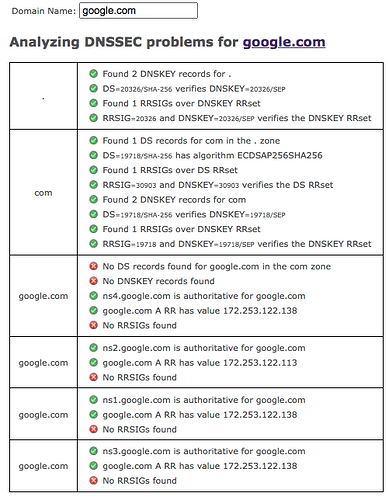

BTW: using the same tool, applied on google.com domain resolves in even more errors, yet the domain name is resolved correctly by unbound.

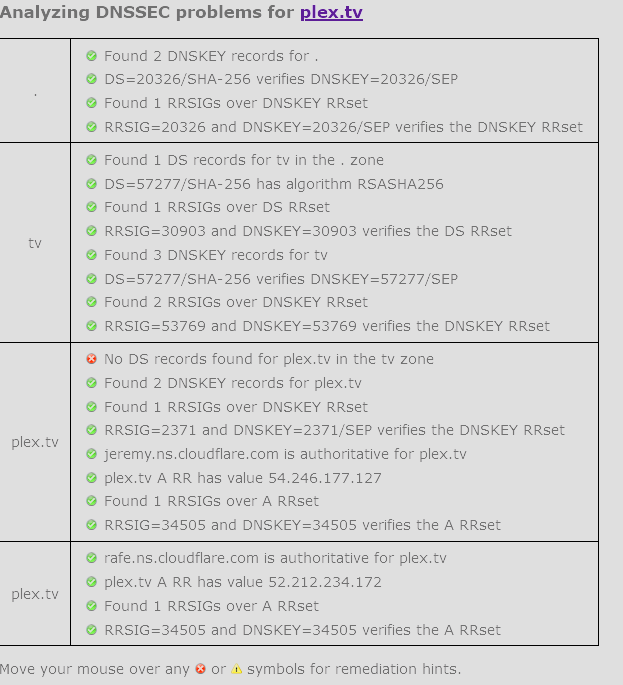

The reason Google and Cloudflare resolve it is because they are not enforcing DNSSEC. The domain resolves fine insecurely, the problem is that Plex have set it up to sign records in the plex.tv zone but then haven't finished the configuration to validate the signatures. The .tv zone owners have published a record that says the plex.tv zone can not be signed. So either Plex sends the proper records to the parent zone or they disable DNSSEC signing of their records. When you combine secure and insecure records in the same zone you get a failure because it looks like someone is trying to impersonate records.
As for the google zone, you can see all of the google.com have a red "No RRSIGs found" which means the records are not signed, and the google.com zone has "No DNSKEY records found". That means the entire zone is not signed and DNSSEC isn't enabled on the zone so there is no attempt to validate DNSSEC for the google.com zone.
Compare that to how Plex has signed RRSIGs and DNSKEY records. They've just broken the chain so that you can not validate the signed records. That's why DNSSEC validation fails, this is one of the situations that DNSSEC was designed for and the failure of the validation is correct.
Edit: It's truly as simple as Plex going in to Cloudflare and toggling the DNSSEC box. Not sure why they don't.
