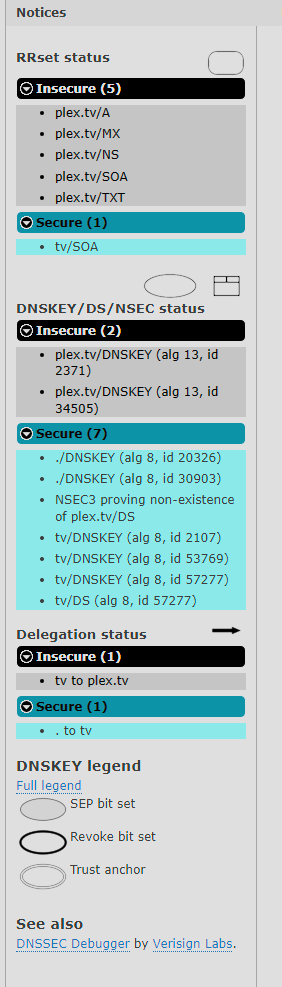

The first line tells us what we already glanced from your previous dig results:
Recursion works for the .tv TLD.
The second line finally tells us why we saw those couldn't get address for '*.nic.tv' failures, despite the addresses obviously being available: unbound can't retrieve the DNSKEY to validate the reply. But as the domain claims to be digitally signed, unbound can not validates it and is thus forced to discard the answer.
As resolution of plex.tv works fine for others (including me), the question is now:
Why does your unbound fail to retrieve the DNSKEY records, and which DNSKEY does it try to retrieve?
As it seems only the DNSKEY is affected, I consider it less likely that your ISP is interfering here.
My slight suspicion now would be about UDP packets being to small to hold the DNSKEY (but I would expect unbound to retry and succeed retrieval via TCP instead).
To find further details, you should try to up unbound's verbosity and run that dig for plex.tv again.
Alright, I raised the logging level to 4. Here's the output of dig plex.tv @127.0.0.1 -p 5335: Dropbox

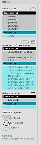

DNSSEC is very easy to screw up. The last image in this post shows the resolution to the issue. It's a problem with the plex.tv zone not being configured correctly. DNSSEC Debugger - plex.tv (verisignlabs.com)
