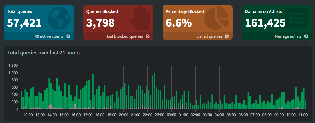

DNS is usually light on CPU, unless you are dealing with a high number of clients and/or DNS requests. By chance, your debug log shows a count of ~64,000 DNS requests during the last 24 hours, or ~2,700 per hour - not enough to break a sweat in Pi-hole, provided they did not all occur in the same split second.
It's unlikely that that happened, though, as there are no respective warnings in your debug log.
Nevertheless, if you see sudden spikes of DNS requests, it may be worth chasing down the client sending them, in order to change its behaviour (if possible).

There is no need to tweak anything here, especially since it would seem that your peak load observations are not tied to your lookup failures.
As mentioned, 60k per day is not an issue for Pi-hole.
A client would need to exceed 1,000 requests per minute to trigger Pi-hole's rate limit (which is a safety measure, not a performance one).

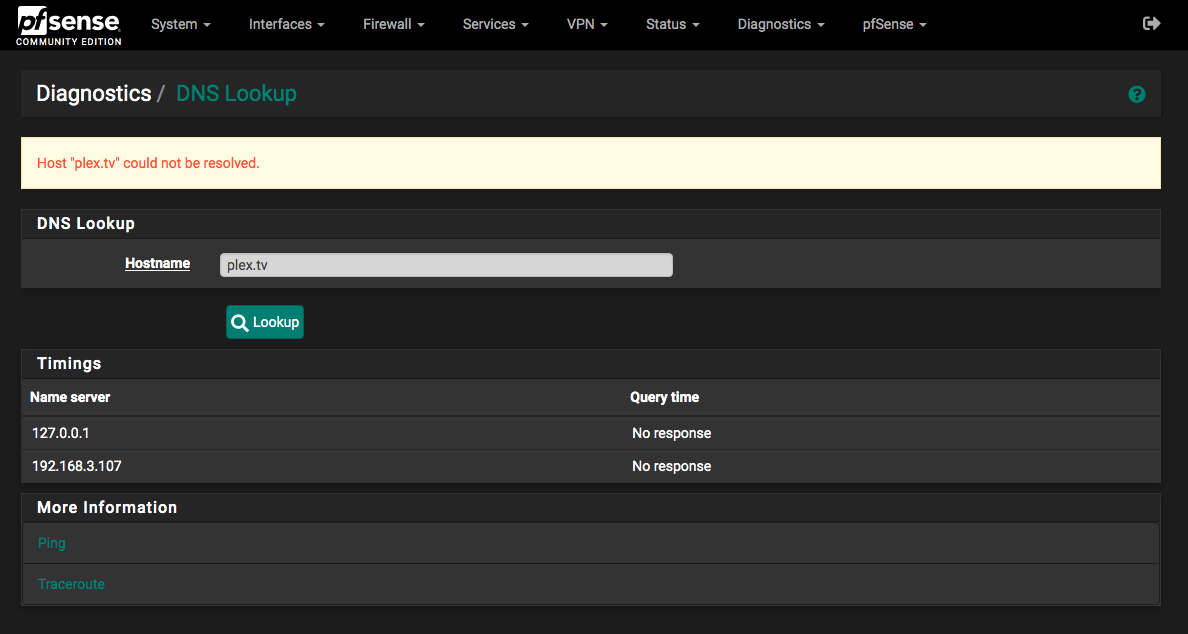

Here's a new development that might help, somehow the diagnosis: I've enabled DNS resolver in pfSense, which is also using unbound, and set DNS Resolution Behavior to use local DNS and then fallback to remote ( set for the IP of the pihole ). Then I did a DNS lookup in pfsense UI, for plex.tv. It failed for both: local and remote DNS. This says we can't talk about an upstream blocking of unbound. Well... at least not in my network. But also seems is not from my ISP ( since when using google DNSs it does resolve plex.tv ).
Is this saying something?
