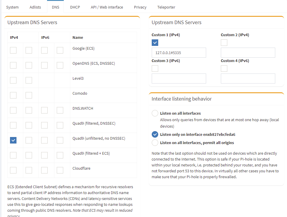

Can't get unbound working with PiHole
When setting up PiHole to use unbound (Upstream DNS Server: 127.0.0.1#5335) name resolution works correctly.
Environment: Raspberry Pi 2 Model B Rev 1.1
OS: Raspbian GNU/Linux 11 (bullseye)
Once I remove any other Upstream DNS Servers, DNS resolution stops working, when pinging a domain I get the following on a Windows 10 machine:

This has been driving me crazy for days. PiHole has been working without a problem for years now.
https://tricorder.pi-hole.net/AU0dk5bb

Also, you mention DNSSEC: In PiHole I have the Use DNSSEC option disabled. Is that required to be enabled?
DNSSEC is being done by unbound. The DNSSEC option in Pi-hole is not required for unbound to do this. Enabling this option in Pi-hole adds the DNSSEC status in the query log.

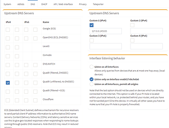

Please correct me, but I think the Upstream DNS Servers option in PiHole should only have 127.0.0.1#5335 and not others. Currently, I also have a Quad 9 DNS selected, otherwise I couldn't even write these lines.
This is how it looks at the moment (so that the network is usable):
Every time you tell me to make changes and test it, I perform the following steps:
  1. make the suggested step(s)
  2. DESELECT Quad9
  3. Click Save
  4. Test if things work
  5. SELECT QUAD9
  6. Click Save
    And then I can use the network again.
Anyway, I am very much prepared to be wrong :slight_smile: :slight_smile: I want to learn.
Thanks for sticking with this issue of mine
This is true. You can remove the Quad9 and your Pi-hole should continue working now that you have fixed the unbound problem. To confirm this, delete Quad 9 server, then run the following commands. The first routes a DNS query through Pi-hole, which should then send it to unbound. The second confirms that the request was processed by Pi-hole and unbound as intended.
