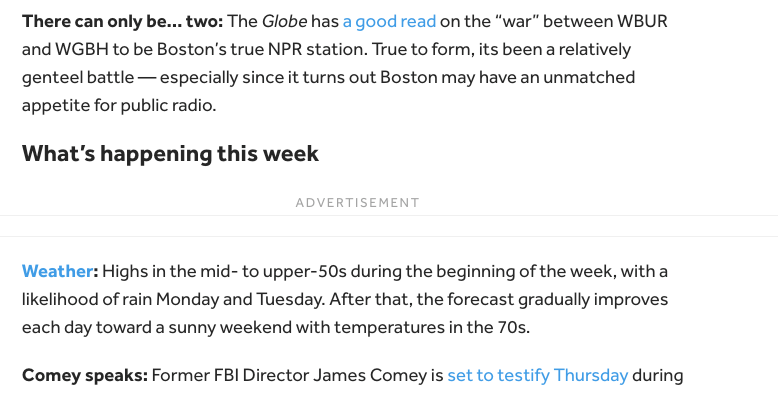

Installed Pi-Hole on my RP3, and went to one of the "test" sites as listed here:
https://pi-hole.net/pages-to-test-ad-blocking-performance/
In particular, I went to https://www.boston.com/ (as per the page's suggestion). That particular site shows ads, everywhere.
Is this normal? I get the "visit this site to show DNS queries", but is the Pi-Hole supposed to block all those ads?
Thanks in advance...

Yes, positive.
I originally forced my machine to use only the Pi-Hole as it's DNS; watched the stats move up from there in the Pi-Hole dashboard. Ads are being blocked, but the ones on Boston.com, and now (I found another site that does the same thing) this one:

Not sure if it's a specific time of ad, or what... very weird behavior.

Flushed cache, still ads everywhere.
Here's something weird; I'm using Chrome 58.0.3029.110 (64-bit) on a Mac. When I use Safari, none of the ads show up. Both browsers had cache cleared out, only Chrome shows the ads. Something else here - if I turn on "AdBlock" in Chrome, it blocks over 60 (!) ads, yet they still show up on the screen.
I would start to wonder if an extension is doing something weird here, but then I realize DNS is being issued network wide, so I can't imagine that'd be it.
Anyone seen this before?

No dice, unfortunately. I disabled the "flag" in Chrome, blew out the cache, reloaded boston.com; ads galore.
It's not a huge deal, as it only seems to be on sites that deliver ads like they do on boston.com, or http://www.popsci.com/... seems both those sites are either owned by the same company or they use the same ad delivery service.
I'm at a loss...

will try those settings with safari.
Very interesting that with firefox dev edition , they are serving images from a different domain.using firefox
