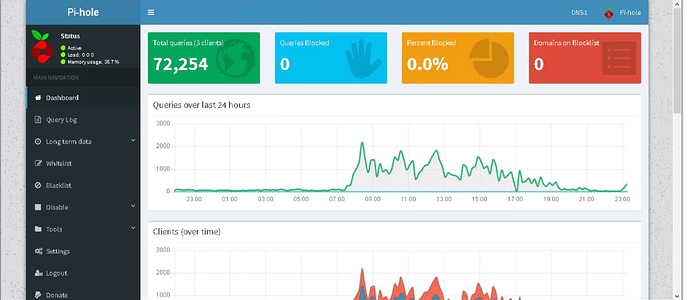

Hi there, I am contacting you because I have a problem with my PI-Hole. As you can see from the screenshots, I have all counter at zero, but the one indicating the requests. I have installed pi-hole again but the problem is still there. I am waiting for your support. Thank you in advance. Regards,

Good morning, thank you very much for your reply.
I have performed both suggested commands, but the problem remains.
Attached you can find the log file generated by pi-hole.
Thanks again

I found the problem.
The lists provided by dsi.ut-capitole.fr/blacklists are not accepted by pihole because they are archives. I replaced them with others in * .txt and * .list format and now everything is ok.
Thank you
