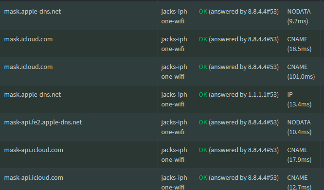

the private relay domains return NODATA is this normal

Your screenshot is showing only allowed queries (nothing was blocked - notice the green background in every row).
Do you see any blocked queries in Pi-hole when the issue happens?
the issue I was pointing out in that screenshot is NODATA

NODATA is a valid response (rfc2308).
"NODATA" - a pseudo RCODE which indicates that the name is valid, for
the given class, but are no records of the given type. A NODATA
response has to be inferred from the answer.
The last screenshot shows queries of type HTTPS. The domain exists, but there is no record for the requested HTTPS query type.
This is normal for HTTPS queries.
The answer is coming from 1.1.1.1 ("answered by one.one.one.one"). It's not an error.
Apparently something else is causing the Apple watch issue.
I thought NODATA was no response, clearly its an actual response, should have looked more into that

No "apple" or "icloud" domains in that list, so it must be something besides a blocked domain.
What else can it be, like I have said if I turn WiFi off on my iPhone it seems to work perfectly
So it’s something with the local network
It’s either got to be Pi-hole or Linux Network Manager
The main internet connection for everyone if shared from a raspberry pi with Network Manager over Ethernet and then WiFi back to the ISP router, I have my own AP for devices
That explained my whole local network, Pi-hole is ran in docker with macvlan onto Ethernet
Is any of this information useful
If Pihole is logging the query but isn't showing a block in the log, then my layman's guess is something else in the network design is preventing communication.
No idea beyond that, though, as I have no experience in anything beyond by R-Pi/Unbound setup (no Network Manager, docker, macvlan experience).
its strange how its intermittent, working fine today
everything else works except the apple watch
Can someone help me diagnose this issue please
If your assumption is that pihole is the issue. A simple test would be to change the DNS on the phone to something other than the pihole and see if the problem persists. Alternately you could create a client group for the phone and whitelist everything for it so nothing is blocked.
The apple watch communitcates to the phone via BT ( by default ) and wifi. You could try and turn wifi off on the watch to ensure its not trying to switch back and forth.
Are there scenarios where the problem occurs? If its intermittent perhaps something is triggering it ( leaving the home network and coming back in, BT range etc ).
Just some thoughts.
I changed to the “allow all” group I have, and still have the issue
I will try a different DNS completely and see if I still have the issue
the issue seems to be with the any wifi network
any ideas, or do I need to contact apple
