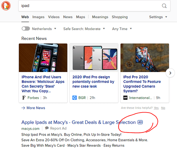

Wow haha maybe i just have the wrong idea of what exactly the Pi hole is supposed to be doing. But i find it completely useless if it can't even block those basic adds on duck duck when any browser extension can do that. Seems like a pretty basic task. But it is confusing because the entire model and any one speaking about the Pihole is literally ad blocking. If Pihole can't block that simple add you circled im confused about what exactly the point of this all is. I just turned on Ghostery i have no ads on any site ever. not even in youtube. But i might have played up this whole ad blocking in my head to an extreme or something

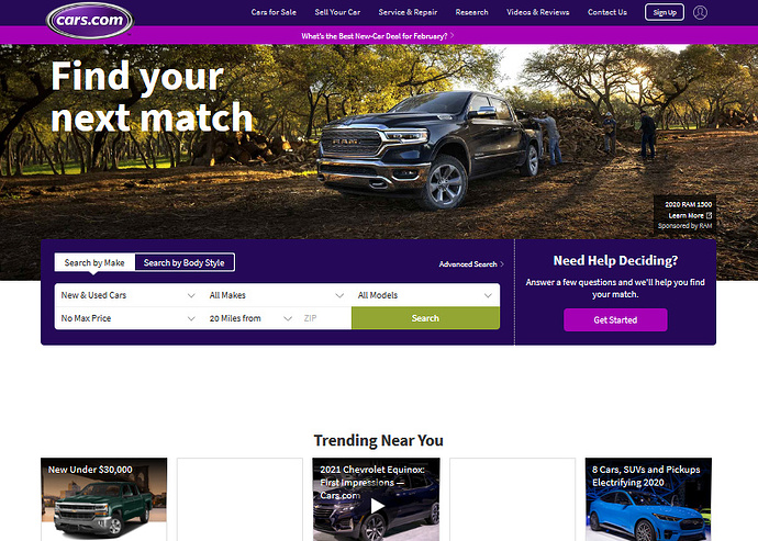

I think i made that token just a bit after installing Pi so maybe there wasn't much activity. But i know my devices are not going through the Pi because when i go on a site on my pc i'm looking over at the Pi monitor and nothings happening. If i go to cars.com on my PC there is nothing on Pi hole popping up as cars.com. Same as my mobile. I get a lot of samsung queries but i still have a samsung ad in the menu section at the bottom left of the TV.

Ads, and other unwanted content, most of the times come from domains other than the one you are browsing to.
So Pi-hole looks up all the domains your browser is requesting against its own blocklists configured below:
http://pi.hole/admin/settings.php?tab=blocklists
If the domain is on any of the blocklists, it returns IP 0.0.0.0 to the browser client (or any app doing DNS queries).
If the domain isn't on the blocklists, Pi-hole forwards the "domain name to IP" query to its upstream configured DNS servers below:
http://pi.hole/admin/settings.php?tab=dns
The answer from upstream is returned to the browser client.
This is very effective for most of the ads/trackers/mallware/cryptominers etc but not all.

So do you have another example on the PC where you suspect Pi-hole isn't doing whats expected ?
You can copy/paste screengrab/shot directly in here.

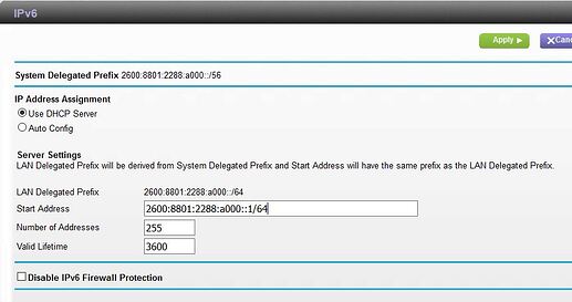

OK here you go. And thanks for helping. Netgear c7800 firmware 3.01.38
You've got IPv6 support upstream and the router is configured to auto assign a bunch on the clients via IPv6 auto discovery (IPv6 address, IPv6 gateway, IPv6 DNS server(s) etc).
Am not proficient enough with IPv6 to give you a good configure advice ... wait for someone who does.

I do believe that the issue is the router's firmware that even if it allows you to put internal (private) IP as the DNS, it will not route and allow that.
Unfortunately this seem that (and only due to) the firmware is the culprit here.

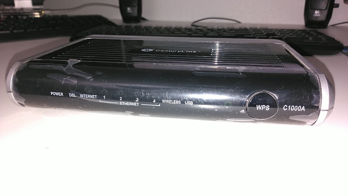

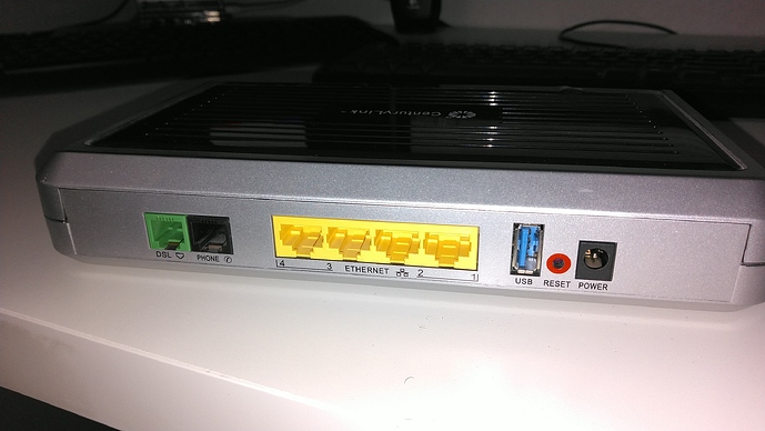

You mentioned cascading route...... is that difficult? I actually have the old modem/router from Century link i bought flat out instead of leasing from them where i used to live. It's just sitting on a shelf. It is an ActionTec C1000A. Would that be something i can use?
That would be both from the device and the router.
On you Windows Computer see if you have an IPV6 IP either by running ipconfig /all via cmd or by looking at your network properties under Settings.
Not at all.
The only problem is that it's adding an additional possible point of failure within the whole network.topology as in "another thing that can fail".
Nope.
Not this one as this is an ADSL modem (old school, phone line dependent).
You would need another router that has a WAN port (where you would connect a LAN port from the Modem/Router combo).
It does take a bit of configuration though as you would have to disable the wireless in your Netgear too (or leave it on with different name and password - but if you can disable it, disable it as it will be less noise on the 2.4 and 5 ghz ).
You next cascaded device would become the primary device to serve all the network.

I don't think IPV6 is relevant here at all once disabled. As I said, I don't use IPV6 and I don't worry about it.
While, in a Windows environment IPV6 is preferred over IPV4, if the IPV6 DNS is set automatically by the router (as self IPV6 DNS - the router IPV6 that is) then yes, everything that is queried via the IPV6 NON Pi-hole DNS, will let ads through.
It works out of the box, you just need to make sure it retains the same IPV6 IP and it's properly set-up in the Pi-hole settings.
Also if you chose to use IPV6, you need to set that IPV6 IP of Pi-hole as your IPV6 IP on the Router.
