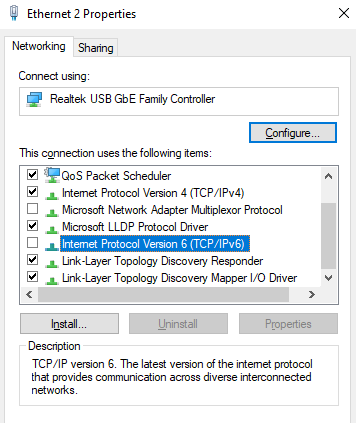

In windows, is a lot simpler to disable it, Just go to the properties of the network adapter and remove/uncheck IPV6.

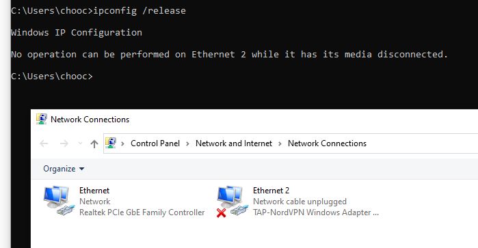

Release DHCP lease on the Win PC:
ipconfig /release
And renew:
ipconfig /renew
And check DNS servers assigned:
ipconfig /all

I got this far and ran into this
Not sure what the ethernet 2 is. I have vpn nord but it is disabled. Has been a few days because i thought it was causing me a problem too so i just left it off
No worries.
Just as long as you see IP details (IP address/DHCP/DNS server) for the main "Ethernet" interface when running ipconfig /all
... after ipconfig /renew to get a new DHCP lease.

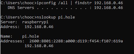

C:\>nslookup pi.hole
Server:  noads.dehakkelaar.nl
Address:  10.0.0.2
Address:  10.0.0.2
Looks good.

No In IPv4 i have it set to manual and i entered the Pi IP in the DSN section and filled in the gateway and ip address. I deactivated the IPv6 by right clicking network and going to properties and clicking the IPv6 tab to deactivate it.
See:
And make sure IPv4 settings are set to auto as well.

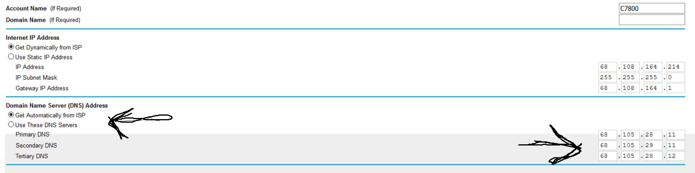

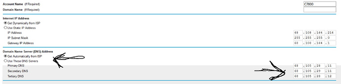

server 2
I think your router is set to use your ISPs DNS. Might try selecting "Use These DNS Servers" and put your PIHole IP into the boxes on the right
