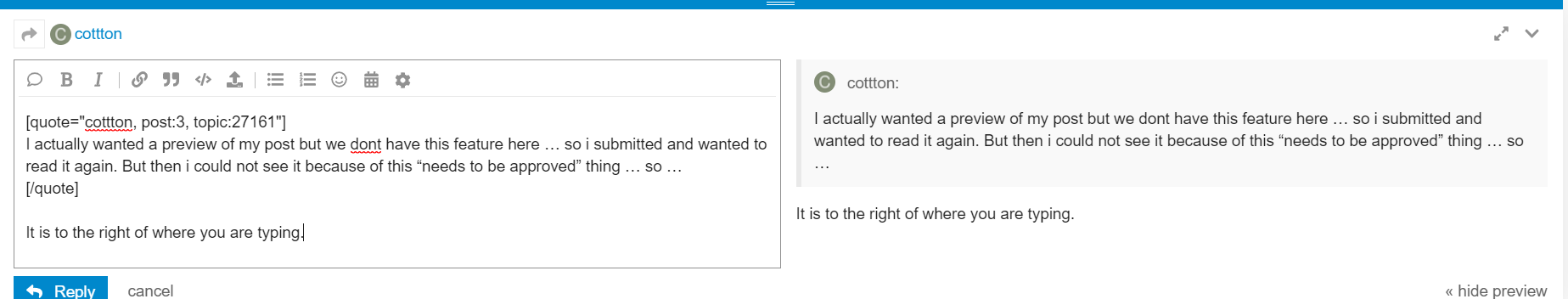

I actually wanted a preview of my post but we dont have this feature here ... so i submitted and wanted to read it again. But then i could not see it because of this "needs to be approved" thing ... so ...

i really have a hard time writing a reply in this kind of popup. You may change this too?

It is to the right of where you are typing:
That's just how it is. You can make the composer full screen by clicking the arrows to the right of the popup:
The markdown syntax is the same as on github...
