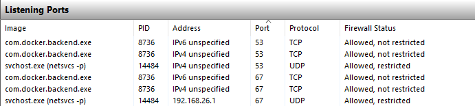

I do believe Docker is listening on ports 53 and 67 based on what I see in "Resource Monitor".
