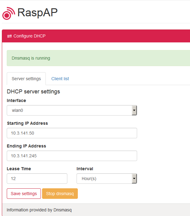

for me dnsmasq is running in wifi bridge
does the wifi brigde works if I remove dnsmasq?
If not, I need an other solution ![]()
Thanks for your assistance
The new Pi-hole is forked from dnsmasq so its got exactly the same capabilities.
But instead of using that "RaspAP" interface to configure DHCP, you can use Pi-hole's own web admin interface to configure DHCP.
If you still run into issues, better create a new thread here to get support.
And post details how you've setup this "wifi bridge".
