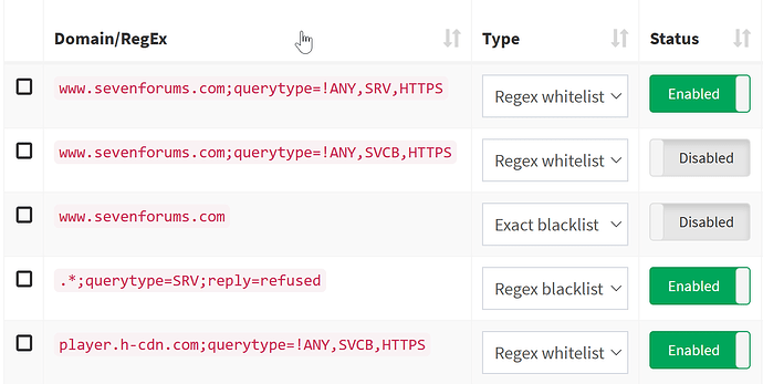

tried various combinations, see below, player.h-cdn.com is blocked by gravity, www.sevenforums.com isn't (no matches)
changed some entries (enabled/disabled) to check the result, some pihole log examples:

everything appears to be working, it requires a lot of evaluation to verify the answer is correct, for example:
it may be very confusing why query type A is allowed (using the regex player.h-cdn.com;querytype=!ANY,SVCB,HTTPS) because pihole -q player.h-cdn.com only returns:

The solution implies there will be no exact whitelist entries, only regex whitelist entries, when attmpting to block a specific query type.
a whitelist example (domain is blocked due to gravity entry):
