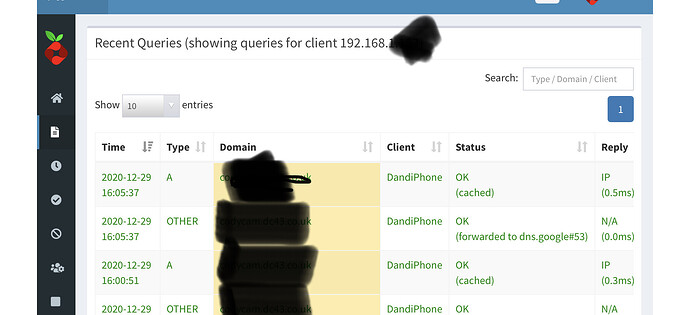

If you look at my image I’ve attached in the post, you’ll see that the DNS lookup is replying with the cached address for the A lookup (the local 192.168.x.x address), and is also sending the OTHER request through to dns.google#53.
What you’re seeing in the image is where I’ve accessed the website twice, 5 minutes apart, with each request being two name resolutions, A and OTHER. The bits I’ve blotted out are all the same sub.domain.com and my network IP.
Pihole for some reason isn’t serving the cached local address when the request type is OTHER.

The OTHER query cannot be resolved, so it isn't in a cache, thus it is forwarded to an upstream resolver, where it is again not resolved. The A query was resolved and has a TTL and is in cache.

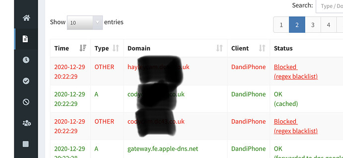

Bloody excellent!!
Thank you very much sir, added and the secondary dns lookup is indeed blocked. THE APP WORKS!
