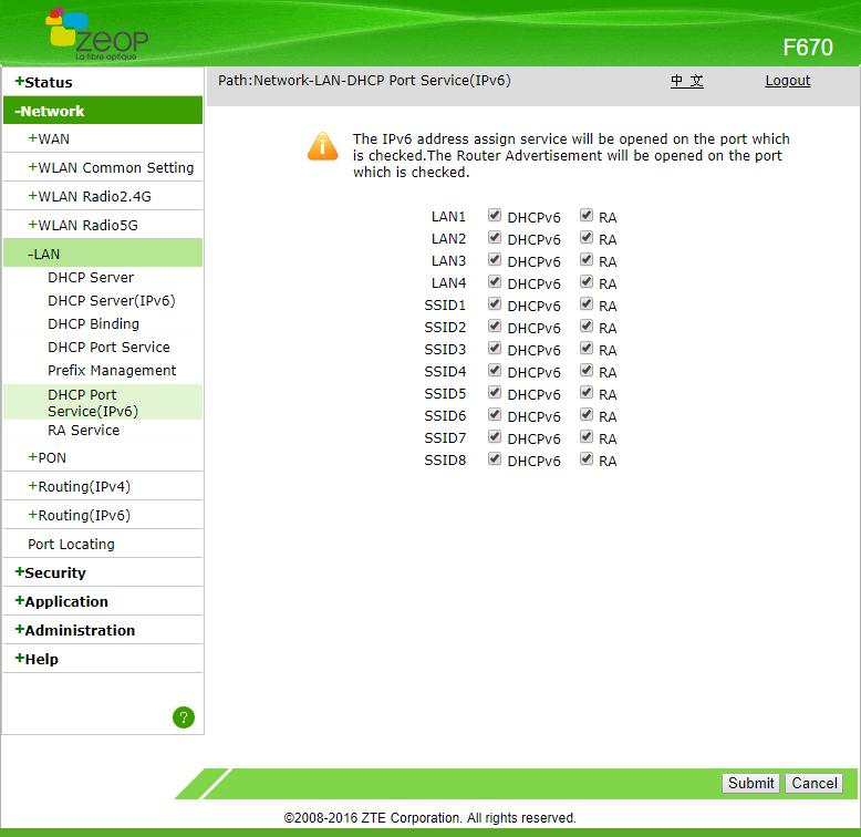

To do so, I think I have to :
  • Disable DHCPv6 (already done)
  • Disable Router Advertisement for all interfaces (so the clients don't get fe80::1 as DNS alongside my Pihole's IPv4)

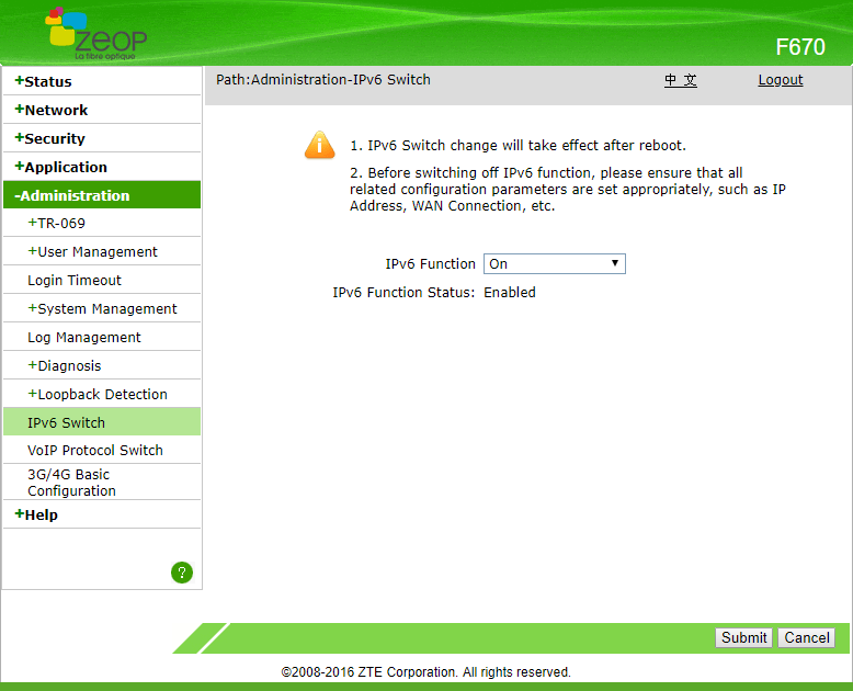

  • Turn off IPv6 switch

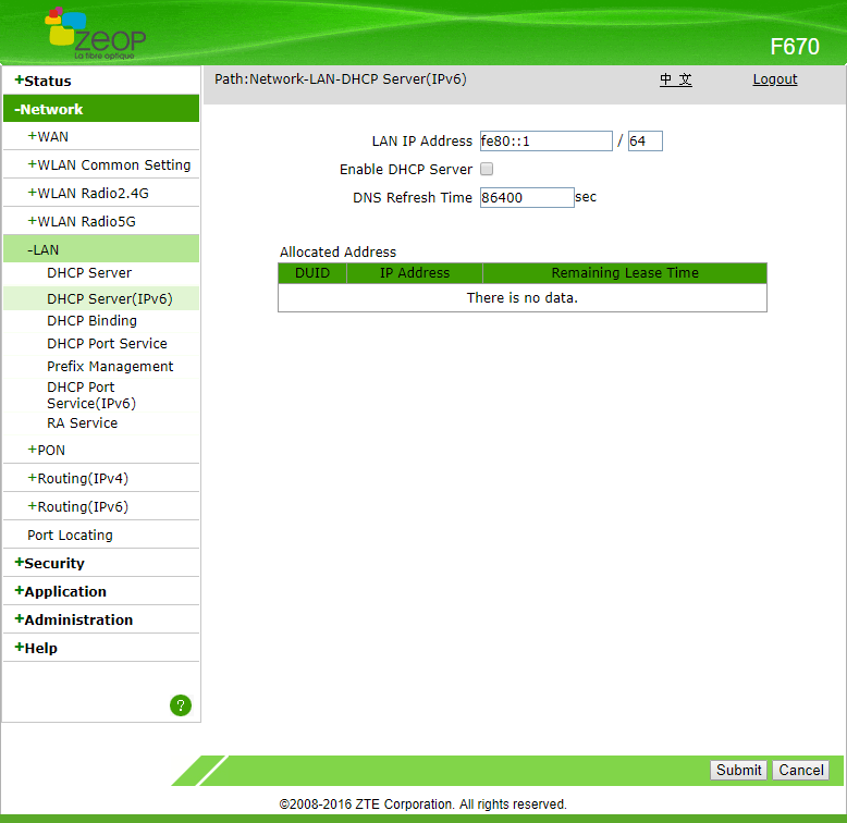

Please see attached screenshots, corresponding to aforementioned points.
What do you think? Is there any advantage to have my LAN adressed with both IPv4 and IPv6 (despite the fact I have no WAN IPv6 address)?
Thanks a lot! :slight_smile:
Your LAN IP Address for IPv6 is wrong. If you want to give your clients an IPv6 address, which is pretty much useless for your network, then you would need to use a ULA range for the addresses. You are trying to assign the loopback address to all of your clients and that is bad.
Just disable IPv6 on your network. Set IPv6 Function to off and be done with it all.
I'm not trying to assign anything, that's the default router's settings. xD
