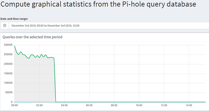

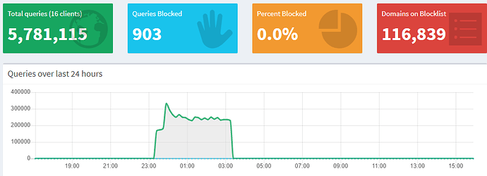

And here's more weird stuff.. look at the query volumes from 11pm thru 03:00... something is querying hard.. but I see nothing in my network logs that matches..

Your above screenshot (post 3) shows that these requests amass during a certain time frame only - roughly between 11:30 and 15:00 hours.
Are you aware of any client device that is active exclusively during that time?
