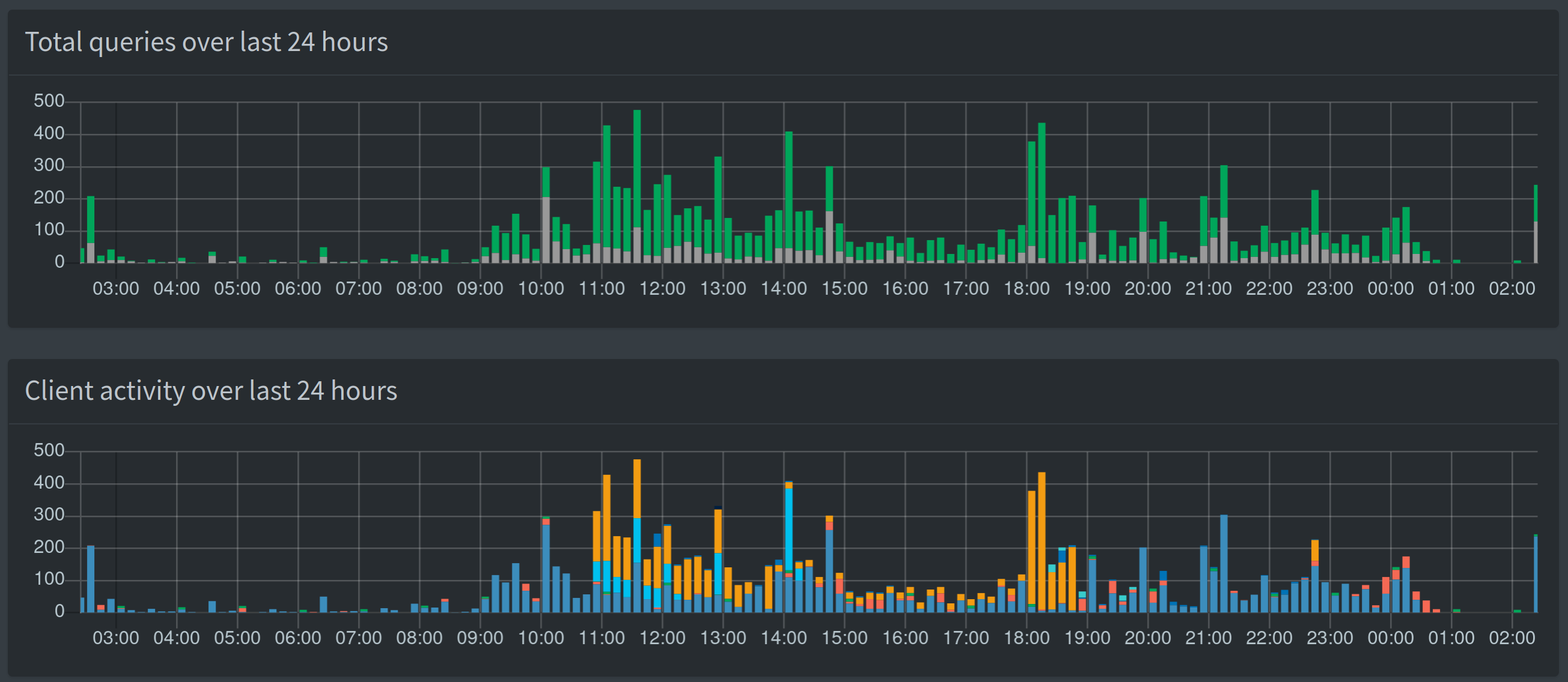

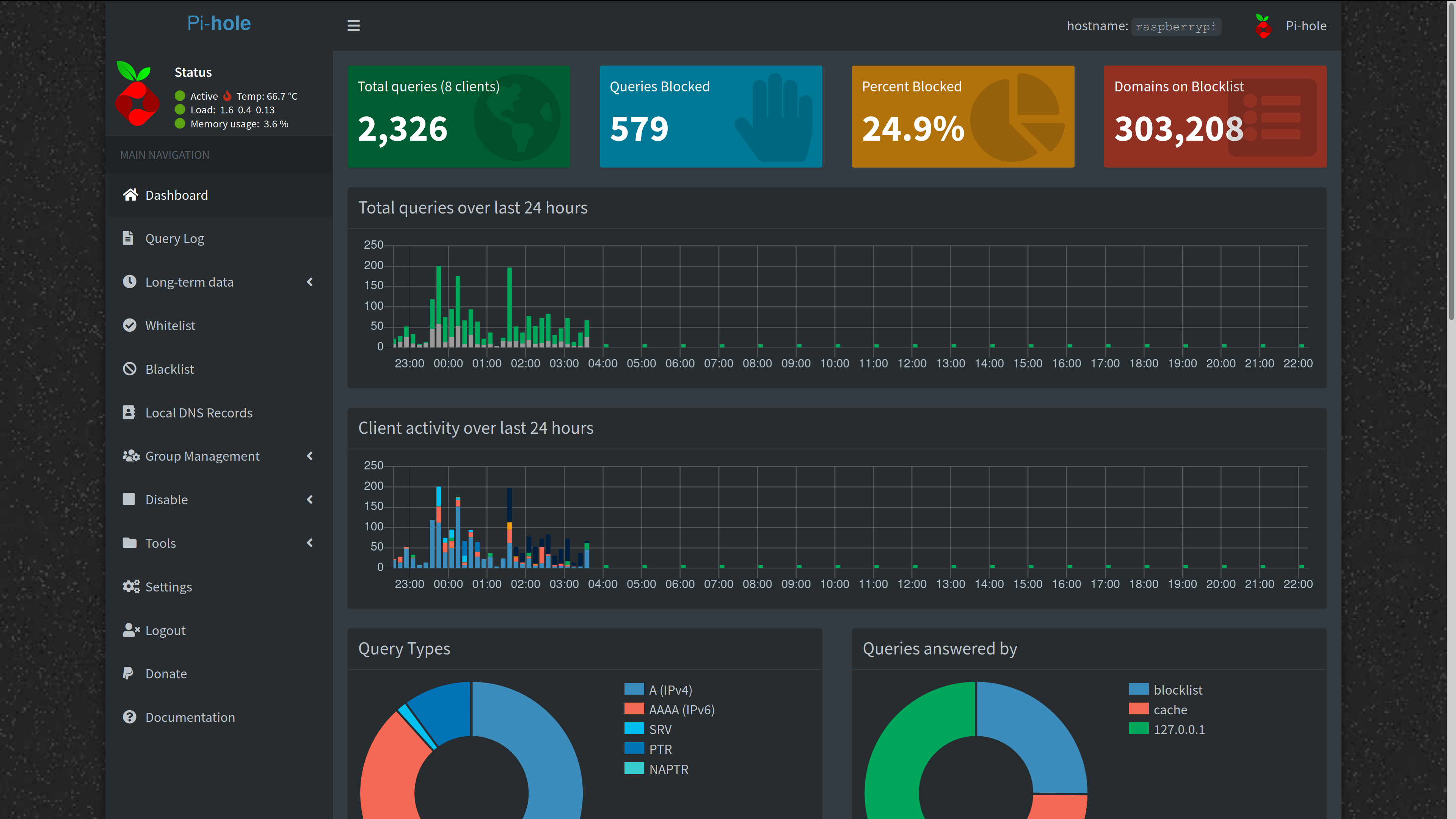

Weird Dashboard behavior. It's fixed, but wish I understand what happened
The issue I am facing:
My Dashboard acted weird (see printscreen), although PiHole seemed to keep working just fine.
I tried rebooting my Raspberry when I noticed it and it seemed to fix it, but I really wish I knew what happened and if there's something I could/should do to properly fix it.

Seems like your clients stopped using Pi-hole for some time.
If that's the case, it would be your clients behaving weird, not your dashboard.
Let's see what amount of queries Pi-hole has processed during that time.

I tried to guess your time frame form your screenshot, but please change exact date and times as required. Be particularly careful to adjust both of the time zone modifiers to your correct value (the current +02:00 value reflects central European summer time).

The strange thing is it just started behaving like that I by chance I checked the Dashboard in the very beginning of the 'incident':
Edit: I was browsing the internet with my device the whole 01:00 - 02:00 time span, but the only client registered in the graph in this span is localhost
