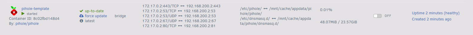

Is this in docker? What is your docker run command or your docker-compose file? You just need to map port 81 to 80. docker run -p 81:80 or something along those lines.
It is in docker.

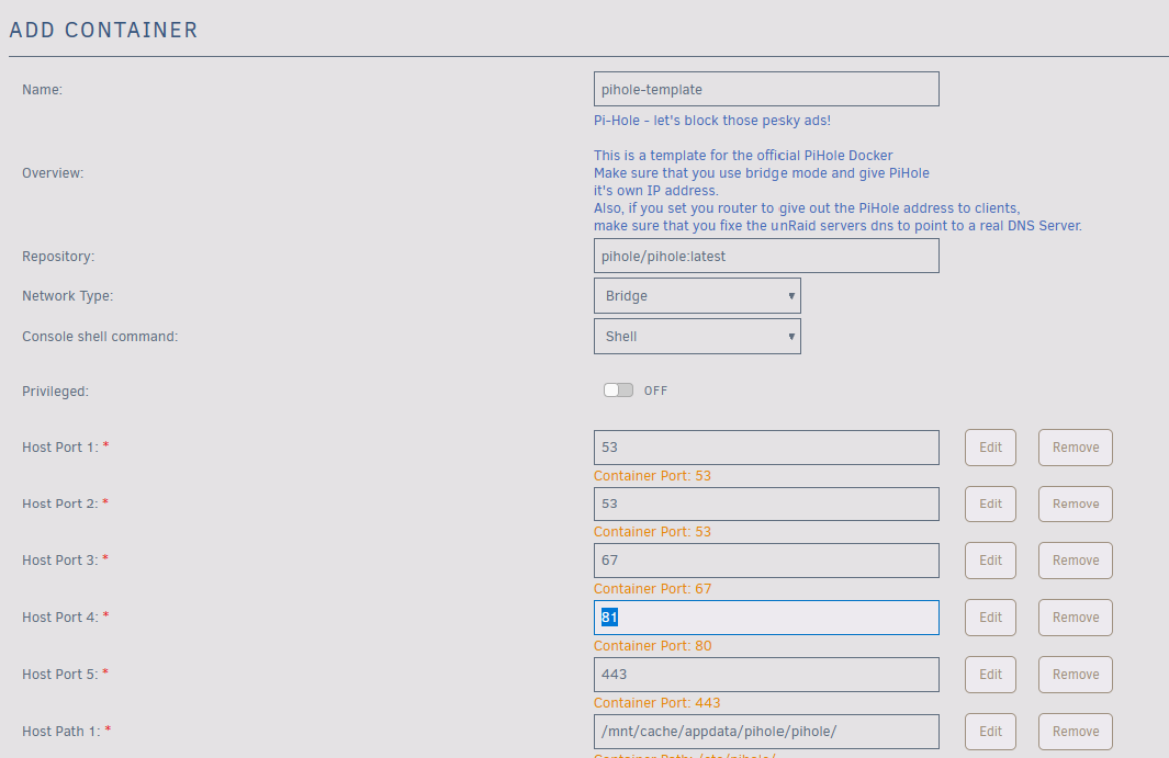

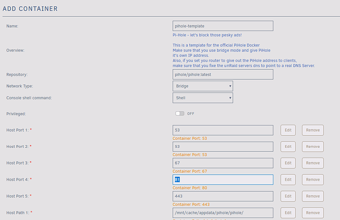

So as far as I know, a docker command can run through root, but not inside the Pi-hole container itself.
When I run docker run -p 81:80 in root.
root@Unraid:~# docker run -p 81:80
"docker run" requires at least 1 argument.
See 'docker run --help'.
Usage:  docker run [OPTIONS] IMAGE [COMMAND] [ARG...]
Run a command in a new container

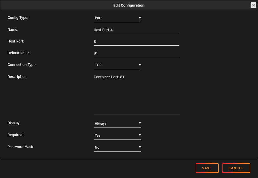

The sample command I gave was to add to your existing docker run command. Where you have -p 80:80 you replace that with -p 81:80 and then use http://pi.hole:81/admin/ as the interface URL.
Oh, I think I see what you're saying.
Here is the the snippet. docker run ... -e 'TCP_PORT_80'='81'
And the full command.
root@localhost:# /usr/local/emhttp/plugins/dynamix.docker.manager/scripts/docker run -d --name='Pi-Hole' --net='bond0' --ip='192.168.1.199' -e TZ="America/Denver" -e HOST_OS="Unraid" -e 'TCP_PORT_53'='53' -e 'UDP_PORT_53'='53' -e 'UDP_PORT_67'='67' -e 'TCP_PORT_80'='81' -e 'TCP_PORT_443'='443' -e 'DNS1'='1.1.1.1' -e 'DNS2'='1.0.0.1' -e 'TZ'='America/Denver' -e 'WEBPASSWORD'='iamunknown' -e 'INTERFACE'='eth0' -e 'ServerIP'='192.168.1.199' -e 'ServerIPv6'='' -e 'IPv6'='False' -e 'DNSMASQ_LISTENING'='all' -v '/mnt/cache/appdata/Pi-hole/pihole/':'/etc/pihole/':'rw' -v '/mnt/cache/appdata/Pi-hole/dnsmasq.d/':'/etc/dnsmasq.d/':'rw' --cap-add=NET_ADMIN --dns 127.0.0.1 --dns 1.1.1.1 --restart=unless-stopped 'pihole/pihole:latest'
WARNING: Localhost DNS setting (--dns=127.0.0.1) may fail in containers.
df352f8cb532bc41e96840b5333e7f88321d8269305b09ce8c176807e887b9c2
http://pi.hole:81/admin/ instantly times out. and server.port still shows as 80. I'm not sure if I'm able to change the 80 port on this distro even though it's one of the options.

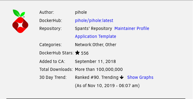

Which template is it? I'll try and grab that to give it a look over.
Also, what does the docker page look like on the unraid Docker Containers page? Looking for the Port Mappings if they are displayed.
It's it's the spants repro.
https://forums.unraid.net/topic/48744-support-pihole-for-unraid-spants-repo/

This docker need ports 53 (dns) and 80 (web) to work correctly. Change your Unraid admin port to 81 or use the new Docker IP functionality in unraid v6.4 to give it its own ip address.
I created a new conatiner with the below configuration, all works on port 81. The Command showing is:
root@localhost:# /usr/local/emhttp/plugins/dynamix.docker.manager/scripts/docker run -d --name='pihole-template' --net='bridge' --log-opt max-size='50m' --log-opt max-file='1' -e TZ="America/Phoenix" -e HOST_OS="Unraid" -e 'DNS1'='8.8.8.8' -e 'DNS2'='8.8.4.4' -e 'TZ'='Europe/London' -e 'WEBPASSWORD'='admin' -e 'INTERFACE'='br0' -e 'ServerIP'='192.168.1.24' -e 'ServerIPv6'='' -e 'IPv6'='False' -e 'DNSMASQ_LISTENING'='all' -p '53:53/tcp' -p '53:53/udp' -p '67:67/udp' -p '81:80/tcp' -p '443:443/tcp' -v '/mnt/cache/appdata/pihole/pihole/':'/etc/pihole/':'rw' -v '/mnt/cache/appdata/pihole/dnsmasq.d/':'/etc/dnsmasq.d/':'rw' --cap-add=NET_ADMIN --dns 127.0.0.1 --dns 1.1.1.1 --restart=unless-stopped 'pihole/pihole:latest'
8c02fbd148d4477d4da203fe25a0cb40dbcd2db4ef08108a58b1669bf13d6b15
I scrapped and removed the file system for pihole again as I see -e not -p when updating the template.
I followed this exactly as you did in only changing port 80 to 81, and now I come back with the command failing. Restarted the server to no avail.
root@localhost:# /usr/local/emhttp/plugins/dynamix.docker.manager/scripts/docker run -d --name='pihole-template' --net='bridge' -e TZ="America/Denver" -e HOST_OS="Unraid" -e 'DNS1'='8.8.8.8' -e 'DNS2'='8.8.4.4' -e 'TZ'='Europe/London' -e 'WEBPASSWORD'='admin' -e 'INTERFACE'='br0' -e 'ServerIP'='192.168.1.199' -e 'ServerIPv6'='' -e 'IPv6'='False' -e 'DNSMASQ_LISTENING'='all' -p '53:53/tcp' -p '53:53/udp' -p '67:67/udp' -p '81:80/tcp' -p '443:443/tcp' -v '/mnt/cache/appdata/pihole/pihole/':'/etc/pihole/':'rw' -v '/mnt/cache/appdata/pihole/dnsmasq.d/':'/etc/dnsmasq.d/':'rw' --cap-add=NET_ADMIN --dns 127.0.0.1 --dns 1.1.1.1 --restart=unless-stopped 'pihole/pihole:latest'
7b8f86e3ec0969ce56595ef8271838e8a737e38d1bbd54ad55566f74eaa65a1e
/usr/bin/docker: Error response from daemon: driver failed programming external connectivity on endpoint pihole-template (a55246178777a4ba3d645c4a2bf038f99e74fe4f48bf10cd5f0bb01acea6f6b6): Error starting userland proxy: listen udp 0.0.0.0:67: bind: address already in use.
The command failed.
