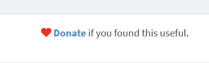

Ubuntu latest build - The version should show at the bottom of the page. It didn't show when I upgraded my v5 install, so I built a new VM from scratch. It originally appeared on there, but has since disappeared.

This is what I'm seeing:
I have no extensions running that would interfere with this. In the same browser, I can access my guest network PiHole and it is working fine.

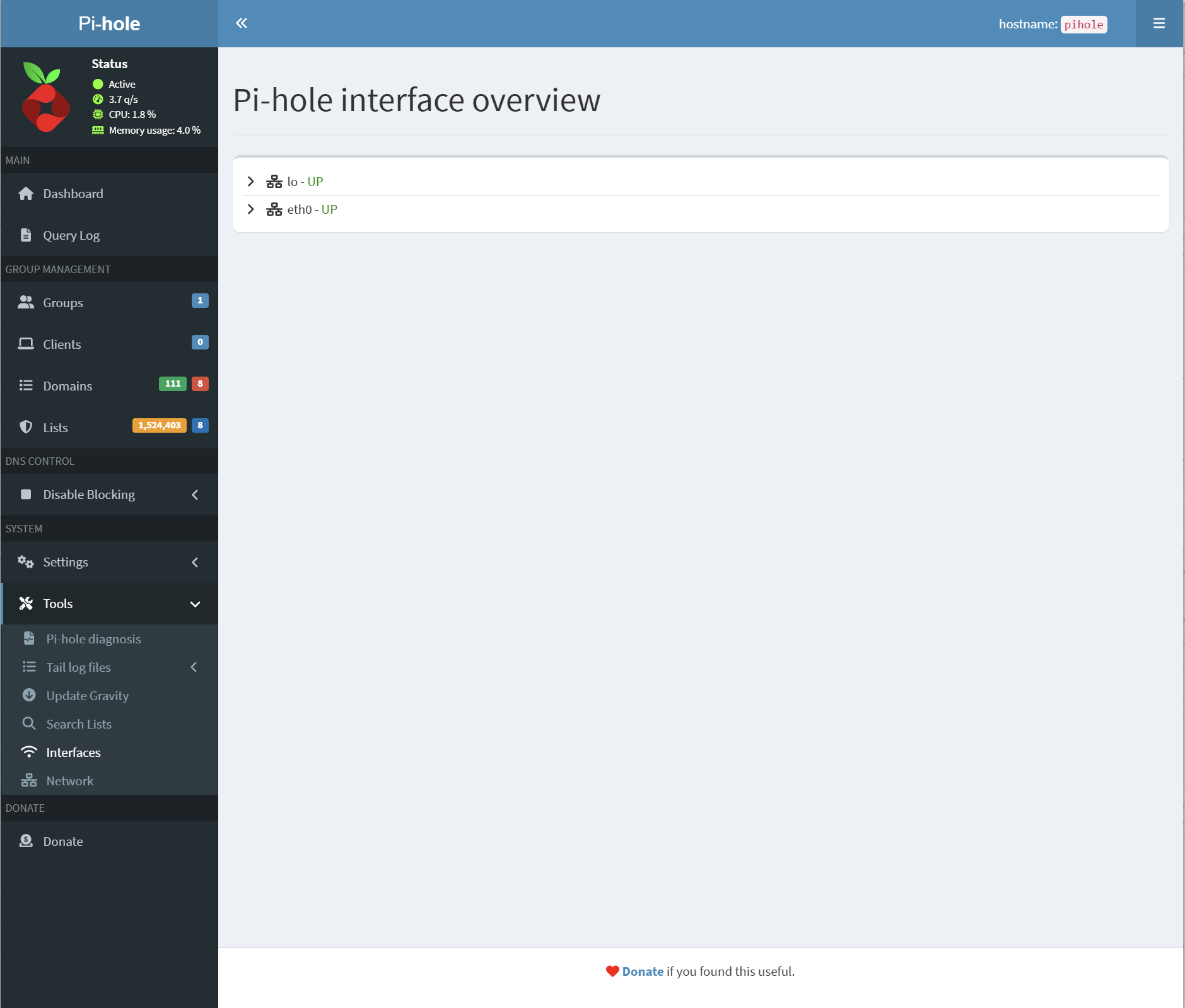

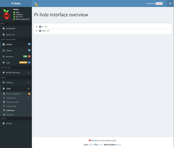

Just for funsies, can you share a screenshot of the whole web interface?
Edit: Also, maybe share a debug log from each and indicate clearly which one is from the "working" one, and which is from the "not working" one
Good guest network:
Bad local network:

As far as I remember, the whole versions block is created in footer.js. The versions block is completely empty (like the image) in footer.lp

Quite odd. The broken version is a totally clean install. The working one is an old install that was cloned and had the OS upgraded as well as PiHole. You would think the clean install would work best...
