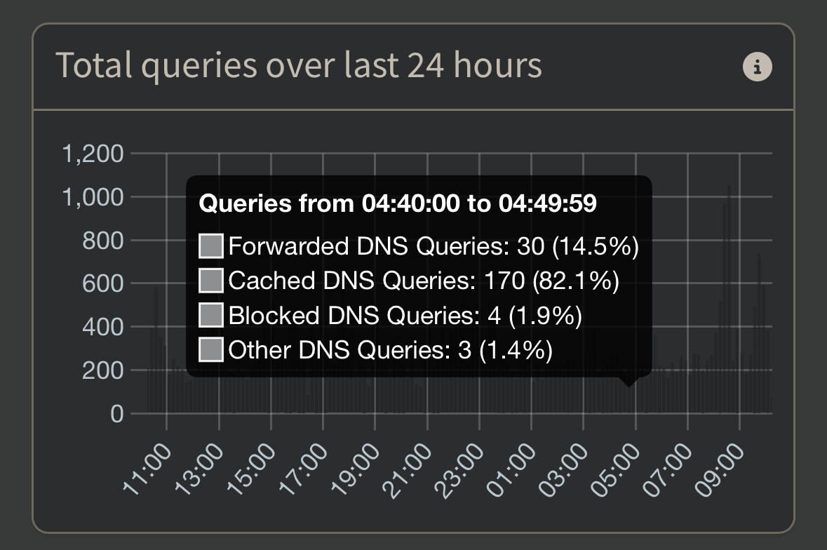

so my main issues at the minute are:
Screenshot 2025-02-19 223723
Should the docker tag be a hyperlink like it used to be
This is the whole reason I took a break from here, no one has actually gave any information about the possible bugs I have found, yes the documentation will help with the variables but that's not going to fix the grey query graph or the fact the docker tag is no a hyperlink
I've split your funny colours post into a separate topic, as its unrelated to your question about your Pi-hole container's environment variables, and thus will need to find a separate solution.
