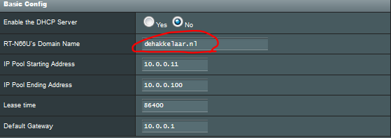

Make sure to change hostname for Pi-hole to reflect FQDN eg:

pi@noads:~ $ hostname -f
noads.dehakkelaar.nl
pi@noads:~ $ host noads.dehakkelaar.nl $(hostname -I)
Using domain server:
Address: 10.0.0.2#53
Aliases:
noads.dehakkelaar.nl has address 10.0.0.2
pi@noads:~ $ host noads.dehakkelaar.nl 8.8.8.8
Address: 8.8.8.8#53
Aliases:
Host noads.dehakkelaar.nl not found: 3(NXDOMAIN)
